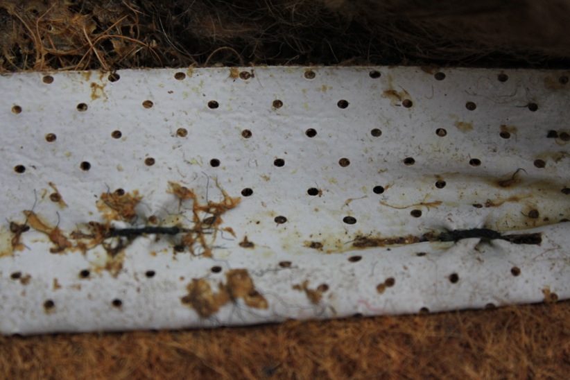

Hello Mr. Nordschleife :)
I´m here to learn from guys like Mr. 66S and Marco, but since you ask my pieces look more "white" than gray. Up close it looks ivory, from a little distance a touch of gray also. I would like to inspect an original car before I make up my mind. Attaching some pictures I just took in natural light. I would say my pieces have less grain than the sample from GAHH that would probably look beautiful installed. I would not use the Sierra Madre material. I have a "correct" headliner probably bought from Porsche in my car, but it does not give the right feel, so I would like to replace it one day.

Attachment 281792
Attachment 281793
