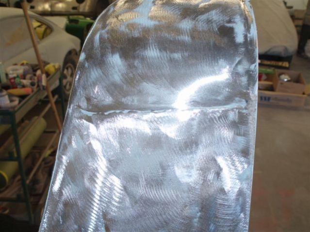

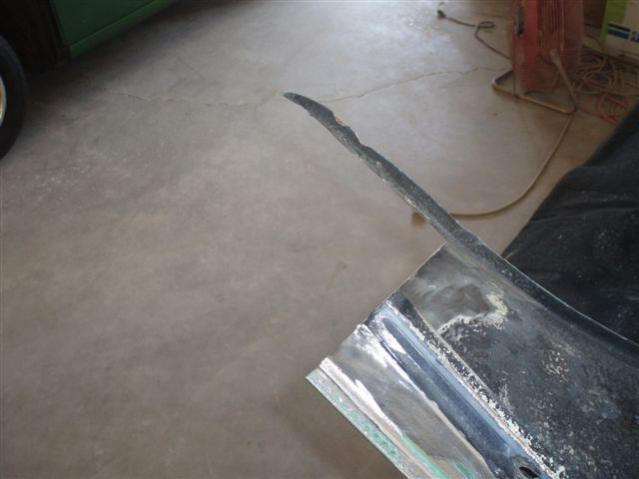

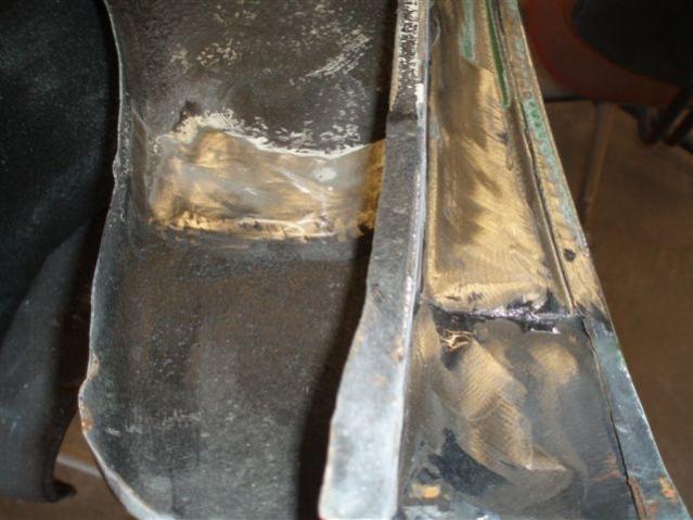

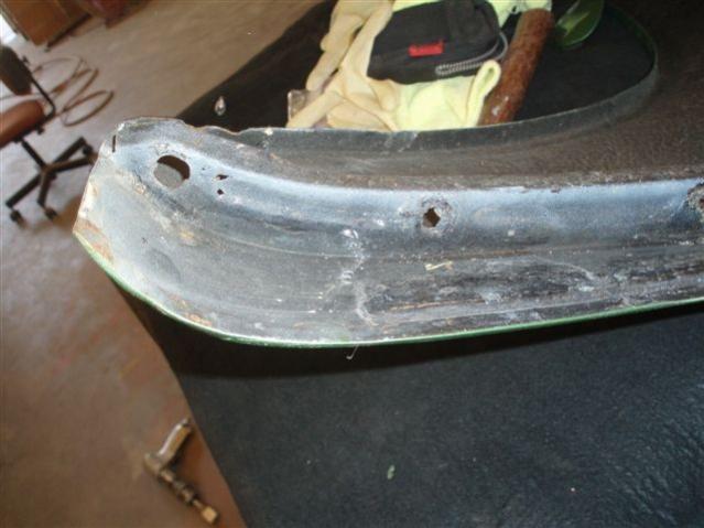

First up was the right front fender, the one with the metal-finished rust repair. That fender wasn’t fitting. Turns out that the replacement metal piece had been lap-welded in. Not good. Especially on an exterior body panel. Lap-welding leaves a small space between the pieces for moisture to get in, which leads to corrosion that will eventually fail the joint and the panel. John repaired the panel by removing the previous repair, then butt-welding in a replacement section. Once that was done . . . John said the panel went right on, fit perfectly.
1) and 2) Right front quarter with Repair One; notice corrosion starting already, in the lower corner
3) and 4) Repair One exposed; notice the irregular edge at the joint, and the small amount of what looks like filler --- that’s a lap-weld --- and that little bit of extra material is why the fender didn’t fit
