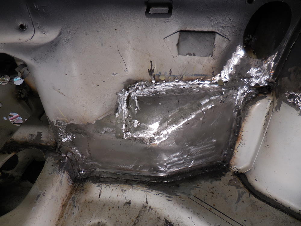

1 Attachment(s)
passenger inner piece with tunnel flange, floor flange, and inner fender flange.... tossed in the "chicken pox" weld spots, for good measure...……...Attachment 494373
Bob
As I said I don't do my own work so may be way off base. The piece that belongs there extends from the longitudinal to the fender waii and around to the floor pan. You can see that I traced it in red on what I supplied. I'm in no position to deprecate your work but I don't think you have accomplished what the missing rusty piece was intended to accomplish. The triangulation of the attachments was to stop body flex. In addition the piece you have welded in may interfere with the floor board. Nice work on fabrication but may not be what you need. Somebody who knows please jump in.
Tom
Thanks Tom …. what you see is the first piece. The second piece belongs along the lines I drew on the floor pan. and overlaps this first piece ... ALL is well because the rusty pieces for this passenger side give me very good "pattern"
when I get the next piece fabricated you will see that it matches the piece you have outlined in red... thanks for your concern. bob
