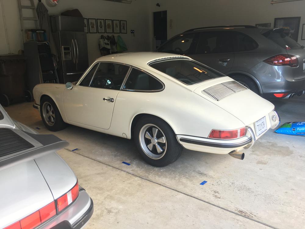

I just finished a backdate of a 1975 to 1970ishS visual spec but with slightly modified 3.0 engine with PMOs and a 915 gearbox Long hood looks w 3.0 liter torque and fun. And I don't have to worry about adding miles to an already expensive car. OH, did I mention the torque :) . Seats were custom made by Stephan at GTS Classic. He took the OEM seats from my 75 911s and made these for me. Notice how he took out some of the padding in the driver's seat so I can sit lower in the car. NOTE: This is a driver's car and not meant to be period correct in any fashion. Harvey did the wheels in 72RS spec finish. Wheels are 6x15 at each corner.
.. and yes I missed my parking marks, my wife reminded me. All the body panels are steel. We bought Porsche Classic fenders and they still took 10 hours a piece to be massaged into place.
