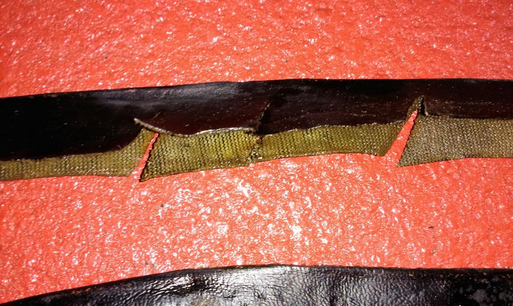

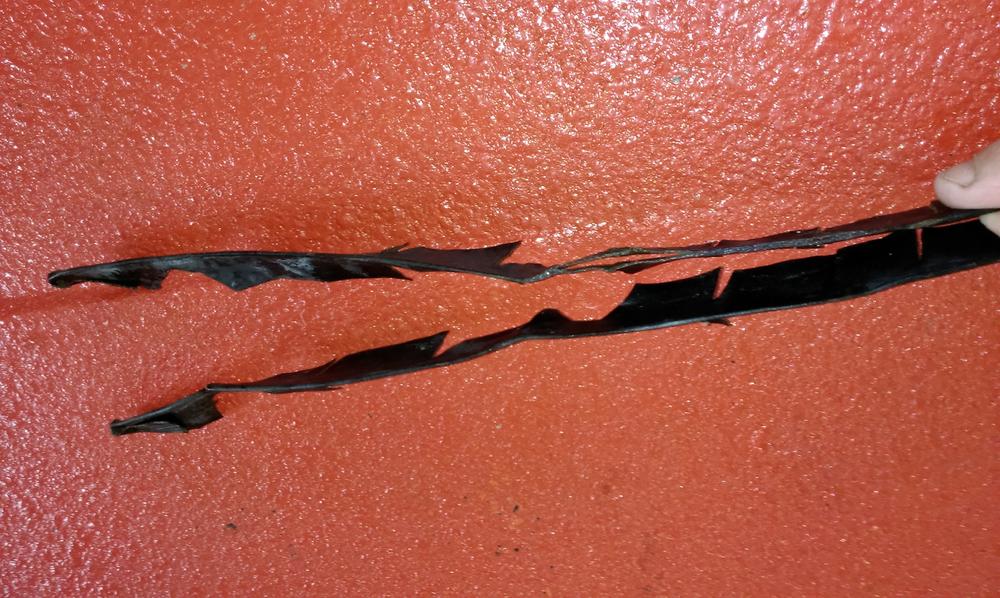

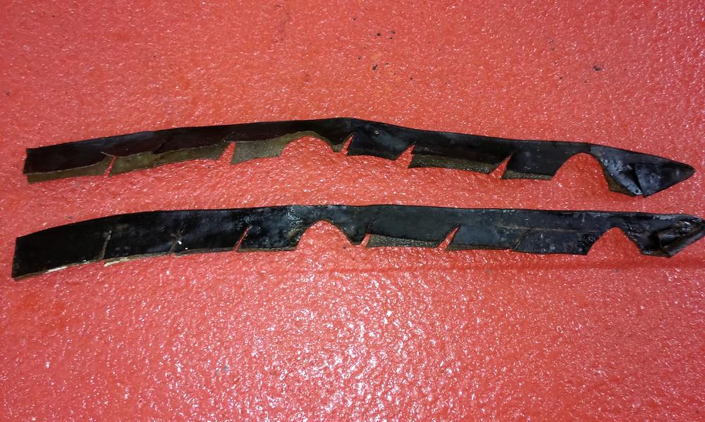

Here is the original fender welt/seal from my 717 car, it appears to me to be normal vinyl (kunstleder) such as would be used to make the seats etc. it is folded over then cut to fit the contours of the fender and bolt holes.

Just to add, 303366 December 65 also had the vinyl fender welt. Still have the pieces
