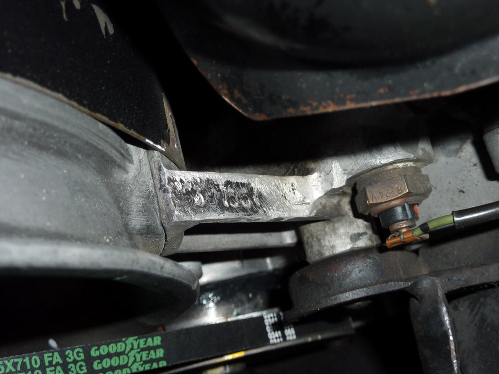

Hello dear 911s mates.
I'm close to buy a very nice Ossi blue, preserved and unmolested 1968 2.0S LWB produced in December.
chassis nr 1193011**
My only big concern regards the engine, that looks very nice and neat, apart from looking it's serial number.
What do you think? Have a look at this pic and help me to understand please...
I have a couple of days to decide if to go on with the deal or not...Attachment 268519

A car with that VIN you mention (69S Coupe) would not have been produced in December 68, by the way. More like April/May 1969
That is a poor photo of the serial #, and the build # would be very important; here are some examples of correct serial #'s:
Thanks Allen, the car is currently exhibited on a show and I had no chance to check the other engine numbers, but I will for sure.
I will check that it shows 901/10, and then the case ones (by the way, what should be the exact code?) if you have any suggestion about where to check it is very welcome...

Thank you very much Davep, I was lookig for some of this pictures to compare.
On Monday morning I will phone again Porsche Omologation service and ask if the chassis nr. I have fits with this engine nr. or not.
Then I will check the other engine nr to be sure that is a 901/10.
In any case I don't understand why they should have grind that way the engine nr. It is a really owful job, anbody would turn suspicious obout it
If you have suggestion to were and what to check it will be very welcome
