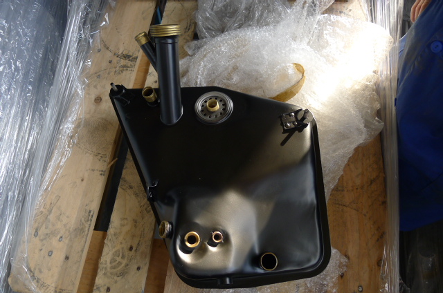

    I got new REPRO´s on stock at 550 EURO + postage
    Drop me a email if you are interested at early911parts@gmail.com
    Marek

    Marek,
    The tank in your photo appears to be a '74+ tank. Can you confirm?
    -Frank

    HI Frank
    it should be a 73 one year only , But I do also got the 74 + with the screw on cap ( see pic )
    Same price :-)
    Marek

    Quote Originally Posted by Marek View Post
    Marek,
    What I believe is a '73 tank is shown in the photo below. Notice that the oil filter console is separate instead of being integrated into the tank as with the '74+.

    Also, as Gled pointed out, the '73 tank is a bit shorter on the bottom. Compare the bottom portion of the tank in the photo below with the one in your photo and can see the difference I am referring to.
    Name:  1973 Oil Tank 1.jpg

    Yes Correct and.. was the 73,5 different and the one I was ref to as a 73 , I got a OK from high places :-) that this ALSO ( the one on my pic ) is a 73 one year only tank
    could it be a late 73 with the old type neck and overlap the 74
    This on your pic ,is the one we are finishing off right now, it have the same housing as the 65-71 tanks we just finished ( pic of the copper plated 65-71 housing )
    just another placement of the inlet neck offcause
    Marek
