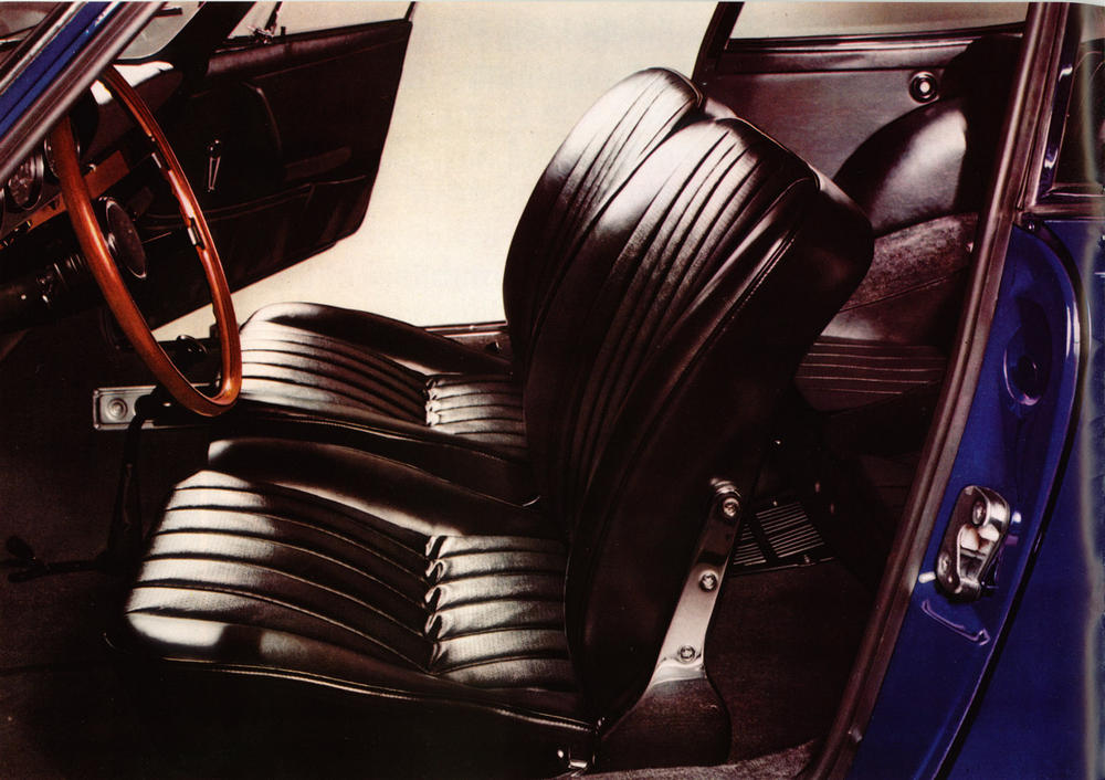

    There was a similar discussion at the 356 Registry, see Question re original seats.
    I believe all the early 911 seats with the pleats running fore-and-aft had the crease but I can only offer proof for the short wheelbase years. Most sport seats seem to have been made differently (pleats running side-to-side) and don't have a crease.
    Some time ago, I saw a how-to: if I recall correctly, there are several strings--a set for each pleat. I suppose the springs could break, could come loose, or maybe even the pockets in the upholstery through which the strings run could come open. Maybe someone more expert than I can tell you the typical failure modes.
    If it helps any, here are pictures from an April 1965 brochure:

    Tom, to answer the question, most of the time reupholstered seats "replicate" the pleating of the original seat. Originally there was a string that went all the way across and it created the loops. The string then went back the other way thru its own loops and pulling it down evenly. If I get a chance tonight I'll take a picture of it from a 914 seat. This process is very tedious to do which is why most upholstery shops simulate it.
    ........ I misread the original post so it's a little off topic but I'll still try and get you that pic of the original string.
