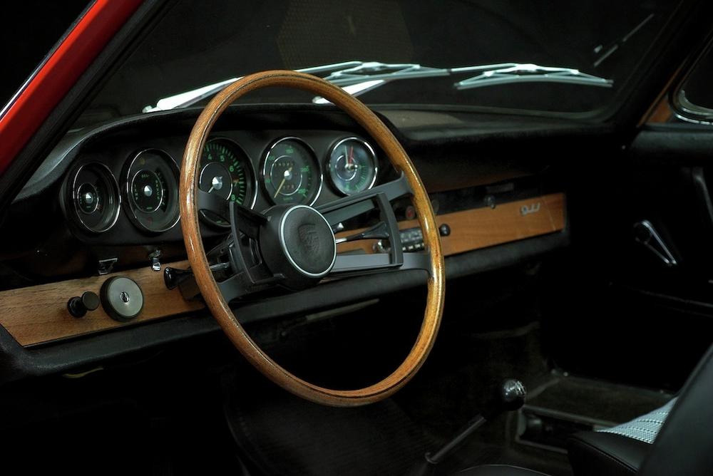

    There's an old eBay auction for a '66 911 (304015, built 28 March 1966) with some good photos http://www.ebay.com/itm/1966-Porsche-911-/390820405161 . There's no way to guarantee it's a perfectly accurate restoration but it does have some good photos which show a large ignition bezel.

    It even has the fibre-backed trunk carpet:
