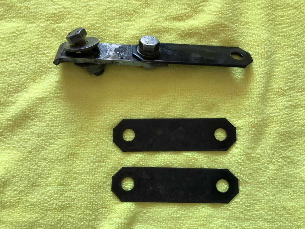

    I have finally got the car home and here is the banjo horn in situ half out and the sets of brackets
    Brackets consist of 4 flat steel plates as pictured in gloss black originally and one much thicker plate with a captive nut that goes to the front bumper mount similar to the 73 trumpet
    The small horn facing forward has 2 small plates joined to the larger thicker plate as you can see in the pic, the larger horn faces down and has 2 small plates only
    Pretty simple to make so I will get on it ASAP
    A set will consist of 4 small plates and one larger bracket
    I have often wondered why the small horn has always had wear marks on the shaft and now I see how the factory coiled the wiring around the horn it all makes sense
    that friction over time does the damage
    I can also properly test my box of horns now too.
    I will advise again when I have some sets available

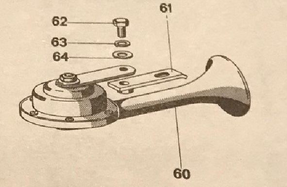

    Thanks for finding this thread. It reminded me that I too am missing these parts. Here are some older diagrams which call out the parts Clyde has displayed above.
