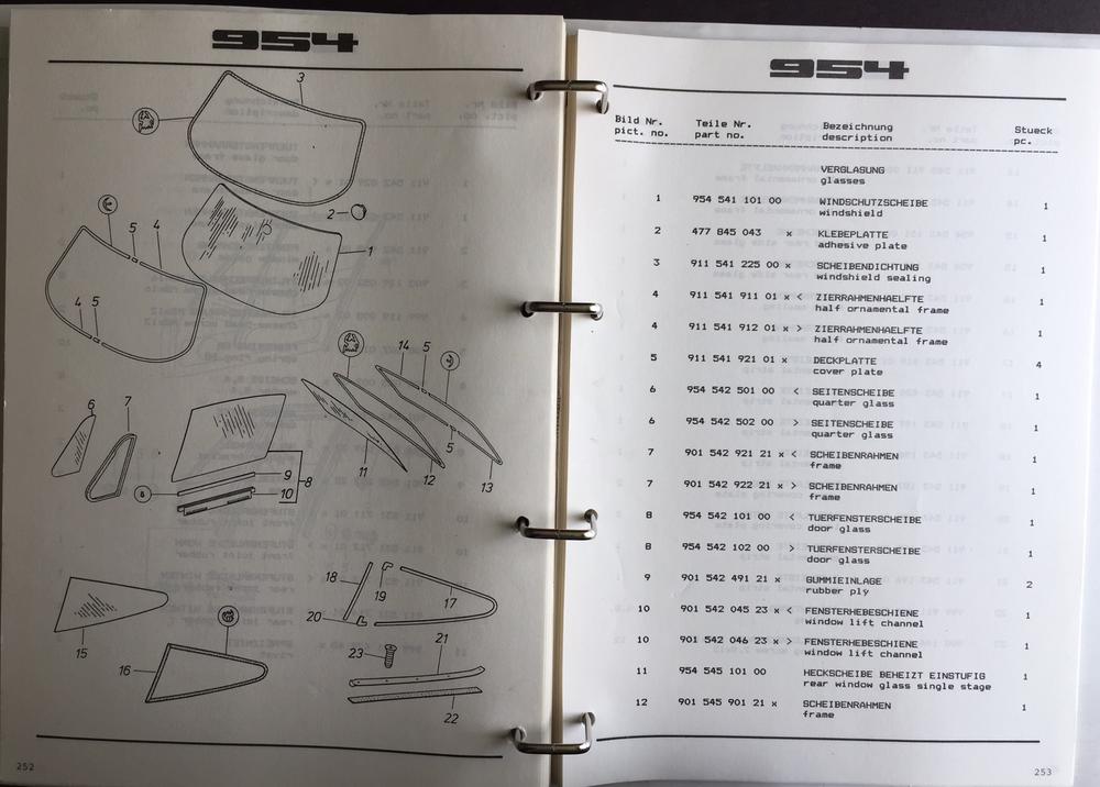

    I thought this would be an interesting note, re: Andrea's original question, Sekurit glass on Carrera RS. When Porsche built the 954 (1985?) A special lightweight glass was used, and made by Sekurit. It's 3.15mm and clear, NO TINT. The below photos show the details on the quarter glass with the Sports Dept. parts sticker, Sekurit logo. The rear window is heated by a single stage defrost element.

    Thank you for the info, Ernie
    The 954 (or 911 SC-RS) is a 1984 model-year only model.

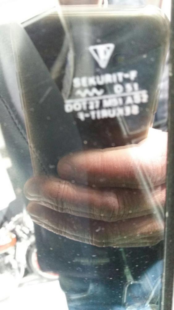

    Here's an example of the specific (?) 2,7 Carrera RS thinner glass. Can anyone confirm if this is Carrera Rs specific, as outlined in the Carrera Rs book?
    From a 2.4S
    2.7 carrera RS, very original car, VIN #6xx. The code on the glass is different.
    another very original 2.7 RS
    Andrea
    Early S registry #1082
