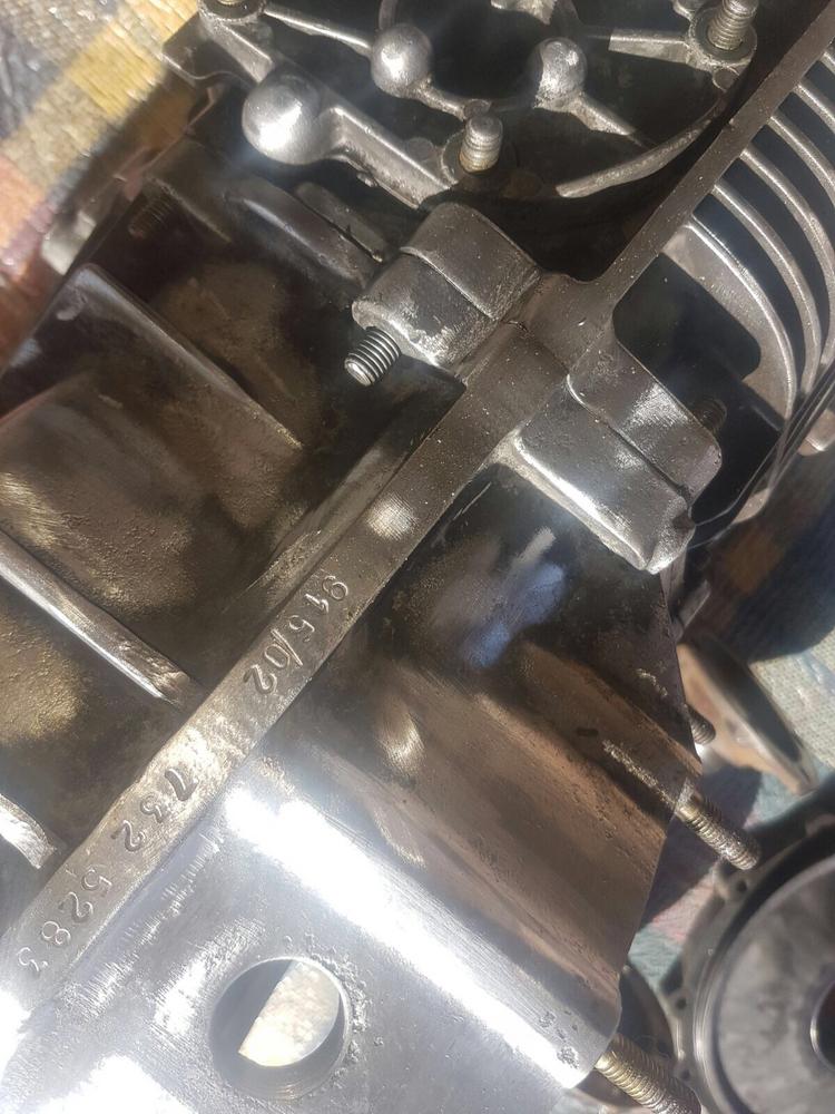

    I just received pictures of the numbers on a 72S car to check they are matching or not.
    With regard to the gearbox, I just expected another font, at least for the type identification. I have no picture of another 915/02 732xxxx box to compare, so I thought to ask you -the experts- immediately for an opinion or comparative pictures. Thanks for your help. Real or not?

    Quote Originally Posted by Adore911 View Post
    Real or not?
    That's NOT where 915 numbers are normally stamped, but 72 was the first year for 915s, so maybe someone else will say they've seen 72s stamped there.
    The numbers are normally stamped just behind the drain plug, on the lowest area of the case. If you can, post another picture of transmission case, showing more of the bottom area.

    No, never seen a # in that location. Here is proper location, factory replacement AT #. G.Led

    And a standard 74#, same as 72 in general. G.Led

    Thanks for your quick responses. Indeed, the part where the number should be has been removed. The number must have been restamped on the wrong location, with different font etc...
    Ok, I will tell the seller I am no longer interested.
