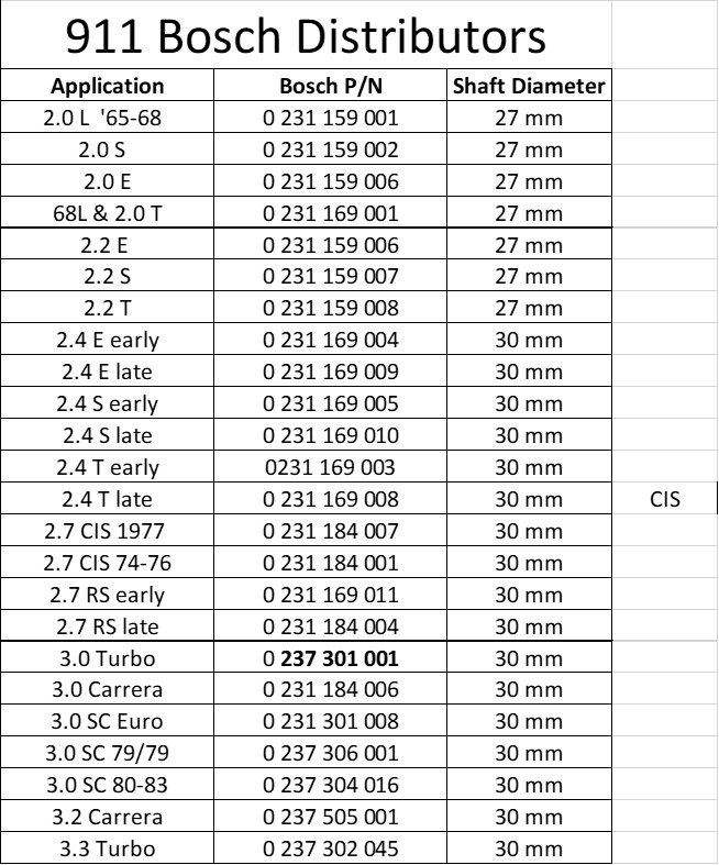

    I use this reference sheet for 911 Bosch distributors

    Tom, on your chart early and late 2.4S are switched, 010 is early. G

    Thanks...I will update the chart.
