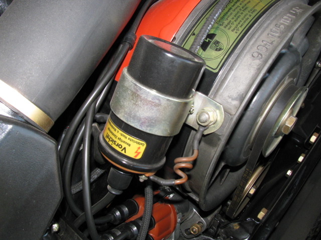

    Had the same problem on my 70T finally saw it fitted to a timing chain cover stud sort of like this. not my distributor, but the picture showed me the general idea.Name:  69+911T+ignition+0041193197191.jpg

    The ignition coil has a blu/yel. wire to term 15. Term 1 is a 14ga. brown wire from the coil term to the 8mm coil bracket attachment stud in the blower housing (one towards rear of car). One braided wire attaches to the 8mm coil bracket stud on the front side of the coil. (towards car front) The 6mm eyelet braided wire attaches to the chain housing stud right behind the distributor.

    picture may help.

    Perfect, thanks Ed. I don't expect this has anything to do with my problem, but I want to touch all the bases.
    Mine will look a touch different as the car had factory A/C and so it has the bracket that moves the coil farther counter-clockwise for rear condenser clearance.
