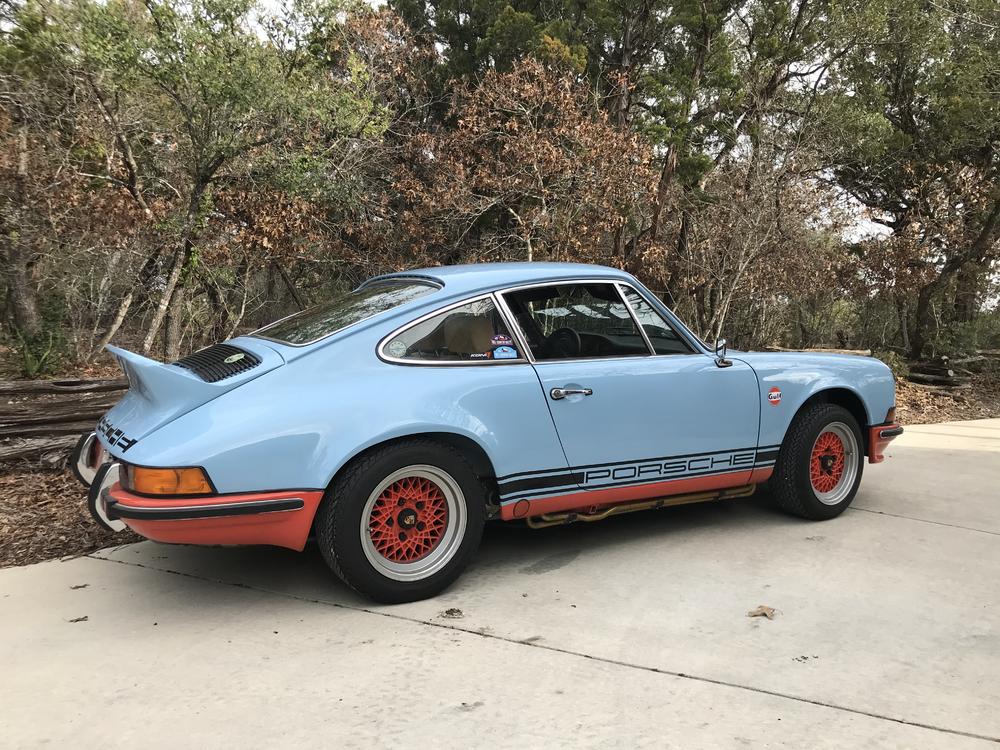

    Done! There wasn’t much interest so I quit posting the details, but I did want to close out this thread.
    Complete nut and bolt restoration. Engine modified to 2.7 S specs with Weber carbs. 915 with factory short shift. I have never completely redone all the suspension on an early 911 and it makes it a dream to drive. Still a few things to finish up- like the AC system, but I can drive it now and boy is it fun! See you Texas folks at Hill Country Rally next month!
