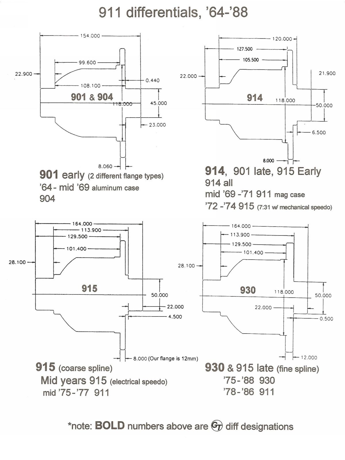

    Quote Originally Posted by ajwans View Post
    My 904 ZF LSD was converted to run in 911 transaxle. It can be done, just not worth the trouble I'm sure...
    Here's a graphic from Guard Transmission on differential dimensions from 64 to 88...
    https://www.thesamba.com/vw/gallery/pix/554461.jpg
    The dimensional differences between the 901 aluminum and 901/911/914/915 mag case diffs are significant, and don't even address the early ZF male -vs- female axle flange issue.
    Jon B.
