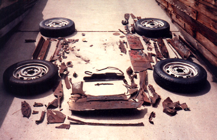

    Eaton,
    after driving, club racing and enjoying this 1964 car for 31 years I can say your car has problems that you have to find and fix.
    First: how solid is the pan? If there is any rust at or near major attachment points, the metal can be moving. (After purchasing this car I drove it for two months with similar handling as you describe on yours. Starting the restoration, after those two months, was the first time I jacked the car, all four tires in the air. Some thing was not right, as I jacked the body moved up but the front wheels barley moved. Got under the car and the front torsion bar attachment was hanging in mid air. I broke out in a cold sweat. The rust was so prevalent. There was also thru rust at the rear of the torsion bar mounts near the back of the gas tank. Along with pans and rockers there had been dubious quality prior repairs.)
    Yes get your car on an alignment rack - are the wheels all facing forward?. And, verify the corner balance. If a prior owner thought they could just crank away on the front torsion bar to set the ride height you could have a three legged dog handling.... sound familiar?
    As you gain experience driving you can try different settings. For the street I had the front weights, also drove many years without the front weights. When driving across the country to race, the front bumper fitted was fiberglass and paired with a ducktail - no front weights. It had a front shock tower brace bolted in. As the wheels got wider 4.5" to 5.5" to 6" and the compound got softer alignments were tweeked and the need for the front weights were not needed. Race weight with a 1/2 tank gas was 2020 lbs.
    When the 4.5" chrome wheels went back on the weights went back in.
    Good luck. If your car is anything like the one I had you will love it.
