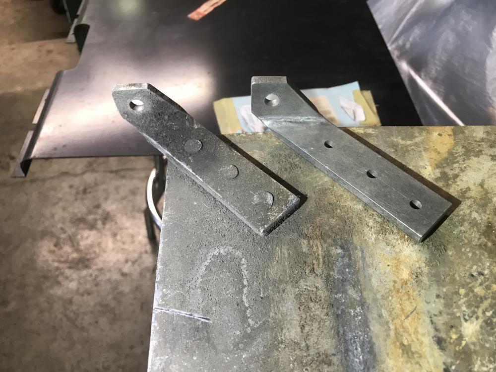

    I believe there is someone else here doing them now.
    I used to make exact replicates years ago copied from originals, both versions in steel and aluminum.
    For the 85L the original aluminum plate works best as it sat about 3/8” lower than the earlier steel plate but I would still add an additional 1/2” spacer block under rear brackets to help clearance the additional depth of the plastic tank.
    A regular factory steel plate will otherwise not fit.

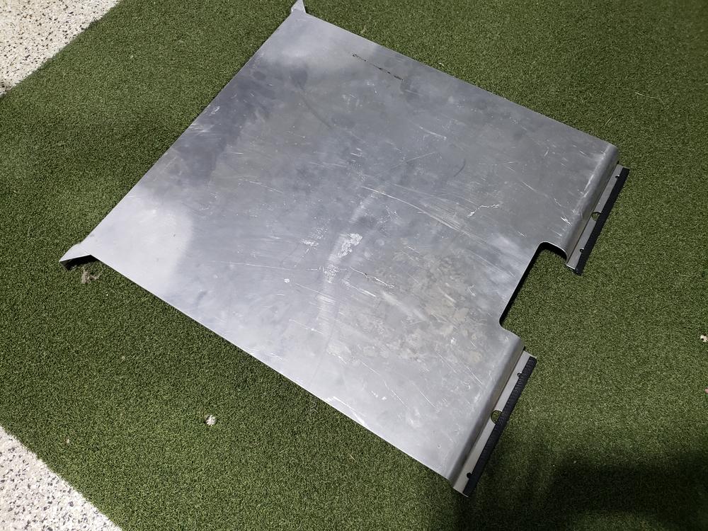

    Scott...I've got this sitting in my garage collecting dust that I don't believe I'll have a project for.
    It's yours if you want it??
    Knowing you, you'll have to polish it or re-finish it in some way. Haha
    Never been used or mounted as far as I know...it's in great condition, not bent or mangled or scraped up.
    Aluminum baby....

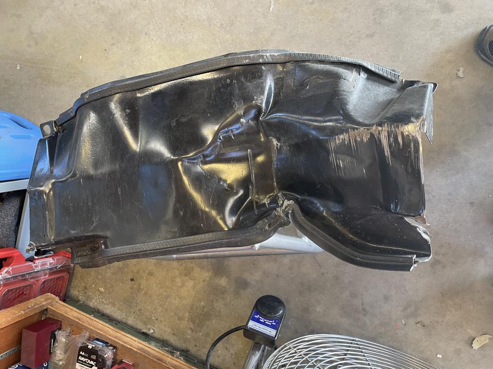

    Steel. A couple inches to the passenger side the fuel pump would be toast. A couple inches to the drivers side the master cylinder would be toast. I’m going to have a plate that goes from the front to the bolts to the rear of the master cylinder and fuel pump. A dump truck dropped a chunk of concrete in front of the car and I had cars all around me and nowhere to go.

    Heck yeah Doug! I'll take it. Thank you. I just sent you a text.
