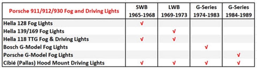

    SWB 1965-1968
    Hella 128 Fog Lights

    Porsche used the iconic Hella 128 fog lights (Part # PCG 631 201 10, Supersedes 644 631 201 03) for a long time, starting with the 1960 356B and continuing on through the 356C and the SWB 911's from 1965 through 1968. Current ones use an H3 halogen bulb and are available with either amber or clear lenses. Porsche designed for these fog lights with brackets and wiring in place at time of sale. They mount under the bumper using top mounts.
    For the model year 1968, A-series beginning autumn 1967 a version of the Hella 128 was introduced that used H1 bulbs (not available in the USA of course). There were two versions, one with the clear reflector, and one with the yellow reflector, which was delivered wherever the yellow fog light was allowed like Italy, France and Germany.

    LWB 1969-1973
    Hella 139/169 Fog Lights

    Porsche switched to the Hella 139 (901.631.205.01) fog lights with the introduction of the LWB 911 in 1969. Unlike the previous 128's, these had mounts on the back. Once again Porsche had mounting brackets and wiring in place when the car was sold. These can be somewhat difficult to find at times but AC usually has them in inventory. Replacement lenses do not appear to be available other than attached to the reflectors - if you can find them.

    Hella 118 Through-the-Grille Driving Lights

    These were introduced in 1968, right on the cusp of Porsche moving from the SWB to the LWB. They were (and still are) a very popular option on the two longhoods. They cleverly mount through special horn grilles with openings cut out of the grilles. Porsche provided threaded holes on the interior for the mounting of the brackets. A number of lamps were used in addition to Hella 118's. Most of them used H3 halogen bulbs with the exception of Italy H1 bulbs were used.

    Cibié (Pallas) Rally Hood Mounted Driving Lights

    Cibie Rally Hood lights are THE driving lights for the F-Series longhoods, both SWB and LWB, and they are also used on later rally builds, including G-Series cars. These produce prodigious lighting as they use H1 halogen bulbs (you will often hear them described as high beam lights). Most choose to paint these the body color of the car and most also use Cibié covers that protect them and look great.
