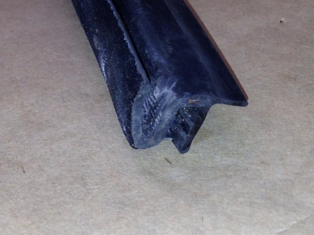

    Here is the pic of piece of rubber with felt that is on inside top edge of my door. Is it correct? It does not extend down past qtr window and there is a gap the last 8 inches or so. What should be there? The parts manual is not very clear. It looks like it would be either part no. 901-531-935-20 L or or 936-20 R. Or 901-531-937-20 L or 938-20 R. Stoddard was no help. They did not have either nor knew which I needed.
    EDIT, I did not mean to make it sound like Stoddard was not helpful, they were, but they were not able to solve answer the question nor supply the needed part. They tried, but no luck.

    No one has responded and the problem continues. Stoddard was zero help. My problem was exactly as others have described. Inner piece against glass has lip that prevent door cap from seating easily. I made it work, but not nice. My windows also are hard to wind up and down. Sort of binding and we can find no obstructions, just hard to wind. Frustrating!
