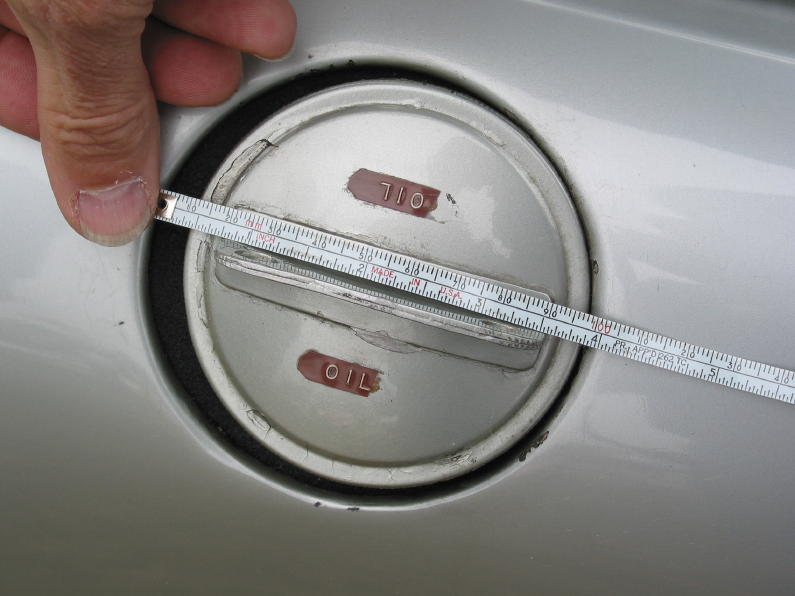

    I have a question about the oil tank filler cap ... what diameter is it?

    As for the oil cap - these pictures should help:
    red arrow = 70mm
    blue arrow = 60mm
    yellow arrow = 80mm
    green arrow (overall external daimeter of cap) = 90mm
