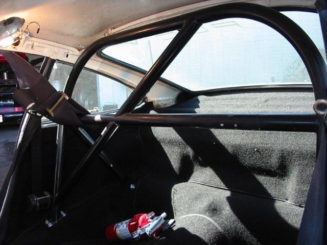

    Dave at TRE installed a custom bolt-in roll bar with a bolt-in cross brace w/fire extinguisher mount and bolt-in harness bar in my 911E for POC and PCA events. It's a work of art. Call him. 818-909-9220.

    Here are a couple pics Dave sent me about a year ago. This rollbar is shifted posteriorly away from the headrest, making it safer (but not risk free) for a dual street/track use rollbar. There are also attachment points to the B-pillar for 69+ cars. You can even get a bolt-in side/door bar for track use.
    This is what I'm thinking of getting.

    The pictures:

    That's the model I have. Great stuff.
