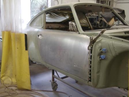

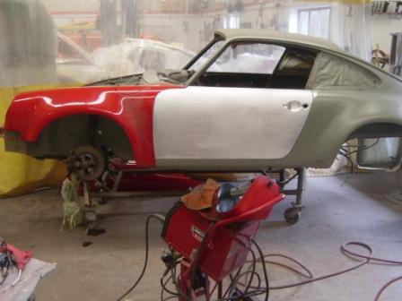

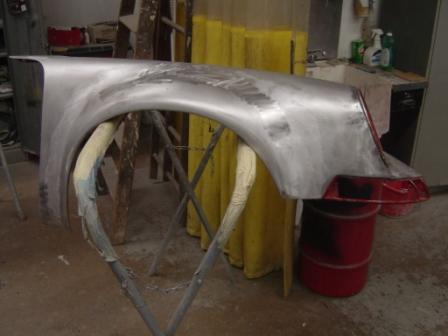

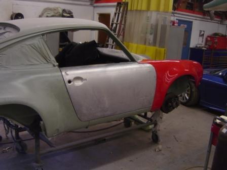

    Trial fit donor fenders and alu door skins
    Here the aluminum door skins and steel front fenders are being trial fitted. The tub is already in factory-look green metal etching primer

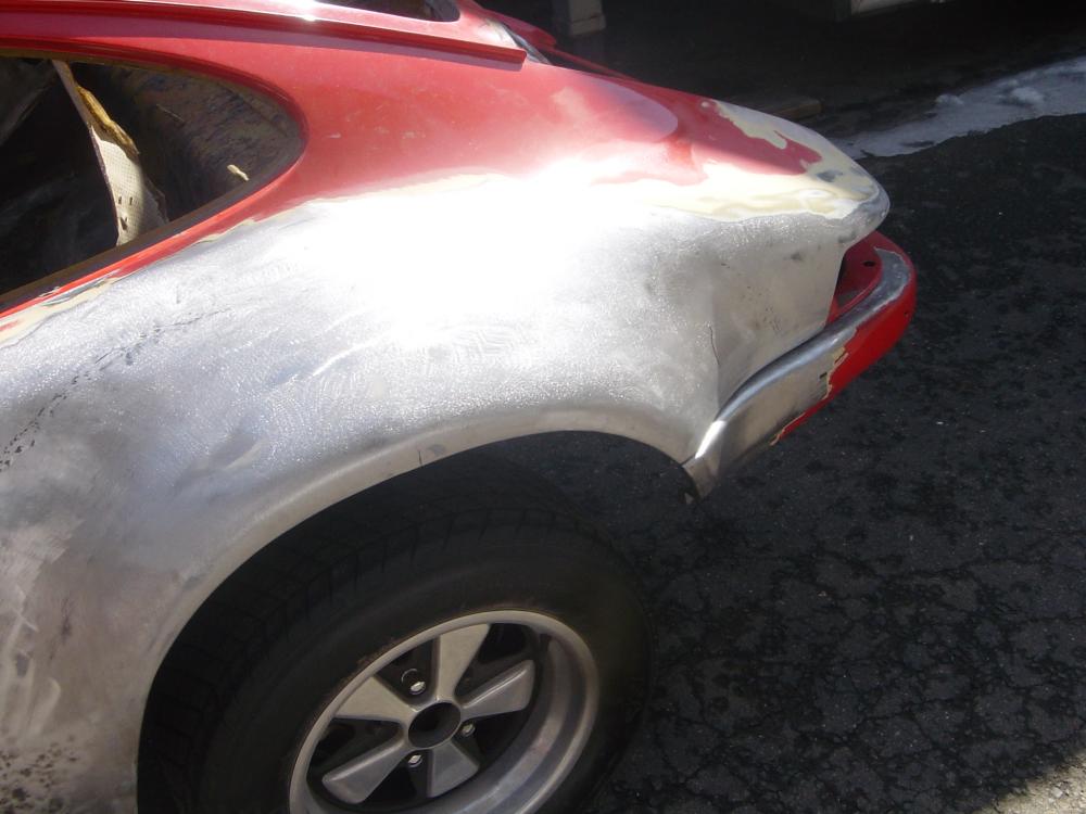

    The used steel front fenders with factory fender enlargements and rear ST flares came from another 1971 coupe here in CT that acted as a most welcome donor. The donor had been dealer modified for its first owner with these flares.
    The creased look of the rear flares is typical of the 2,3L ST cars. The last image shown below dates from 2007 when the rear flares were cut from the donor and butt welded to the project car. Rim is 9" x 15" minilite. Tire is Dunlop Racing size 4.30/11.60-15 as specified on page 5 of the factory booklet Information Regarding PORSCHE Vehicles Used for Sports Purposes 2. Edition From Model 1970.
    911.503.903.00 Wing extension, rear, left (steel for 9" rim)
    911.503.904.00 Wing extension, rear, right (steel for 9" rim)

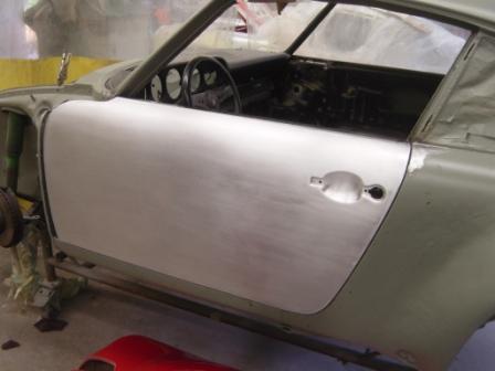

    The alu door skins were provided by a board member in LA. They came to him from the big Vasek Polak garage sale in Hermosa Beach some years ago. The guys at the shop were pleased with how well the skins aligned on the original door frames and matched up with the body contours.
    911.531.901.00 Door exterior panelling, left ALU
    911.531.902.00 Door exterior panelling, right ALU
    The standard specs for the ST did not include the aluminum door skins. However, the part is listed in the spare parts list and there exist examples of ST doors with ALU skins in place. I suppose the teams most observant of hot rodding's Third Axiom, ADD LIGHTNESS, were left to re-skin the doors post-delivery or ask the factory to do the work as an extra cost option.

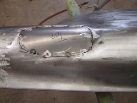

    The fuel door is being welded shut on #694 as the car will use a big tank, either 110L or 100L, with under the hood or through the hood center fill, respectively. We are leaning towards using the 100L with through the hood center fill.

    Thanks for the kind words. Yes, there is nothing like metal worked bare steel and primer to get one's imagination going. Image below shows butt welded ST flare being rough shaped and matched to steel rear bumper.

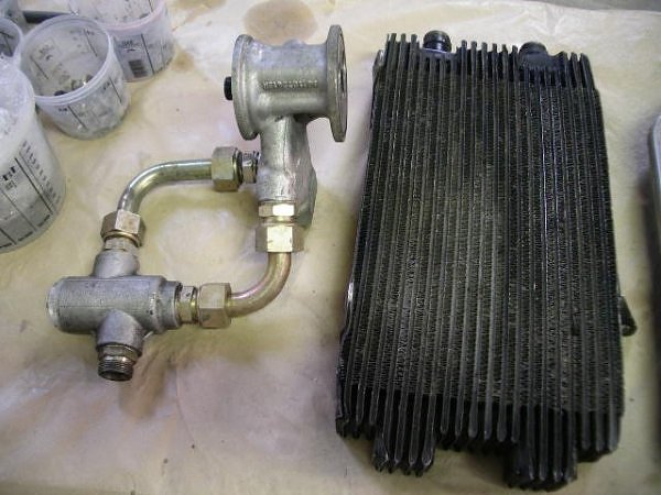

    Coolers for hot rod
    Hi Bert:
    Thanks for the inquiry regarding the oil coolers used for this project.
    Actually, we are using oem factory coolers manufactured by Behr. Here is the explanation:

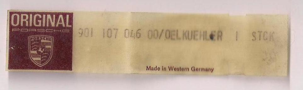

    On the RH side we are using a normal 911S period oil cooler. The Porsche parts number on the sticker shows 901 107 046 80/OELKUEHLER and has a small yellowish (although it might originally been white) sticker showing 060372. I assume this is the date of manufacture. It is European practice to date sequence in the order of day-month-year so I suppose this stamp is meant to indicate March 6, 1972.
    An image of the part number sticker on the RH cooler appears below as an attachment to this post. Note that the tag identifies the origin of manufacture as Western Germany indicating a date of manufacture preceding the reunification of the German state.
    On the LH side there is a "mirror image" factory cooler which simply has the mounting tabs reversed for this fitment. This one is lacking a parts number tag but has the same little yellowish sticker except that this one is stamped 080372, or March 8, 1972.
    Both have the usual raised BEHR lettering on the side plates.
    The aluminum tabs on the LH or "mirror image" cooler appear to have been hand welded a bit more crudely than the relatively cleaner manufacture of the RH piece. I assume the alu mounting tabs were simply welded off the production line at BEHR for this limited application. The tabs are dimesionally the same and of identical design as on the RH unit.
    These mirror image coolers may be the same ones used on the 911R, but I don't know for sure. I have not seen a part number in the 1970 Competition Spare Parts List (the parts bible for ST comp parts) for the LH cooler but perhaps Boba or Gib knows of one. I do not have access to a 911R parts manual and perhaps a number is listed there.
    The coolers and hard cross over lines need to be mocked up for fitment in the fenders and the fuel bay prior to cutting the access holes in the inner fenders. The access holes are necessary so that soft hoses can be plumbed through the inner fender to mate up the hard lines on top of the coolers and the hard lines running through the fuel bay and routed just behind the gas tank. I will post pics when the car reaches that stage.
    Interestingly, there are no part numbers listed in the Competition Spare Parts List for the hard lines either, although there exist period photos of factory cars so equipped. This was probably the most practical way to go and was just left up to the race teams to fabricate lines as they deemed fit.

    Great project Tom!
    Front oil cooler should be like this one,69/72...

    A quick note:
    All 'early' front coolers are the same from '69 to '71, the exception is the '72 that has the 'later' bigger fittings...
