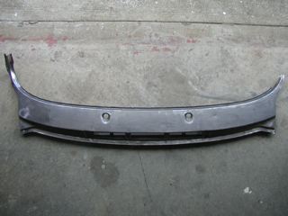

    cowl repair 3
    prepare the donor cowl. finding a good one is important. thanks to shaun budka (shaun 69e) i struck gold with this one.
    separate all spot welds and strip paint. again the lap weld at the inner fender joint is the hard part
