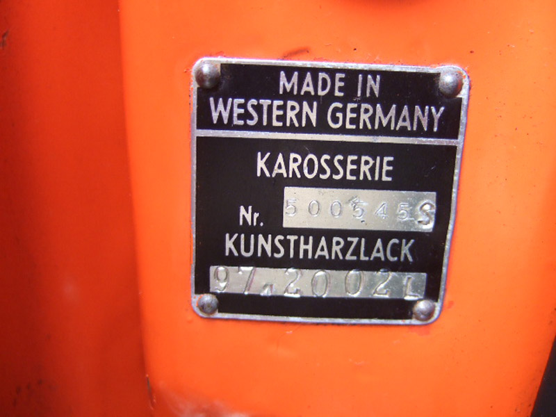

    My understanding is that there is a difference between blood orange and tangerine, but I'm not sure what the difference is, or when it occurred in production. Dave P indicates that I have a tangerine w/ paint code 002L.
    My follow up question is what paint source do I use to replicate the color for a respray?

    Its the same color, with the same code. Its the English color name Tangerine(a citrus fruit) and the direct translation of the German color name Blut Orange(a citrus fruit, looks like a red orange).
    blutorange
    1968/1969, code 1 6809, and code 2 P2002
    1970/1972/1973, 018
    1971, 2323
    Code varied by some model years.

    No, I don't think there is any difference between the color names, blood orange comes from blutorange, the German name, but in English we call it tangerine.
    blutorange is color # 018 and code P2002 in 1967 with Lesonal brand paint, 6809 in 1968 & 1969, but possibly P2002 if Lesonal brand paint was used, then code 23xx (2323 or 2310) used for 1970 & 1971. Finally, from 1972 through 1983 code 018-x-y was used.
    Now I am a bit confused since the Lesonal list shows P2002, but all others of that type were Rxxxx codes. I need a good photo of the badge to document what they actually stamped onto the badge. This is the only one I have, and it does not show P or R:
    Hello DaveP
    the image you show is exactly what I've got on my car....only mine is a bit smudged and hard to read.
    I will try and get a clearer image of it for you...
    cheers
    tom
