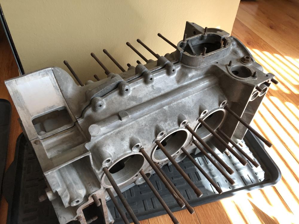

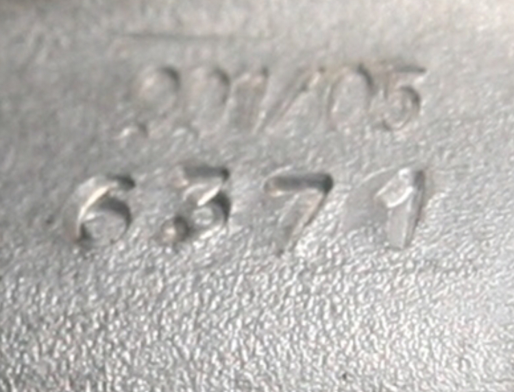

  5. #775
    Nov 2017
    Victory
    134
    903722
    901/01
    3627
  6. #776
    Banned
    Nov 2004
    Scottsdale, AZ
    9,752
    Quote Originally Posted by Kismet View Post
    903722
    901/01
    3627
    Hummmmm...
  7. #777
    Feb 2012
    Netherlands, Leiden
    2,191
    Number seems to be in the range? Or does it looks like a re stamp?
  8. #778
    Banned
    Nov 2004
    Scottsdale, AZ
    9,752
    I think it may be the original number.
    I also think Wolfgang may have overindulged during lunch.
  9. #779
    Oct 2008
    Burford, ON, Canada
    4,239
    Not the best effort at stamping the numbers, however they do match perfectly.
    Kismet, can you also get photos of the mating #'s on the top of the case, and the casting date codes from the pulley end for me please.
  10. #780
    Nov 2017
    Victory
    134
    Numbers on the top of the case
    Dave,
    The numbers on the top of the case on either side are 456
    There seems little to suggest these numbers have been restamped as the surrounding finish appears to be the original sand casting
    Casting appears to be 4th month of 65
