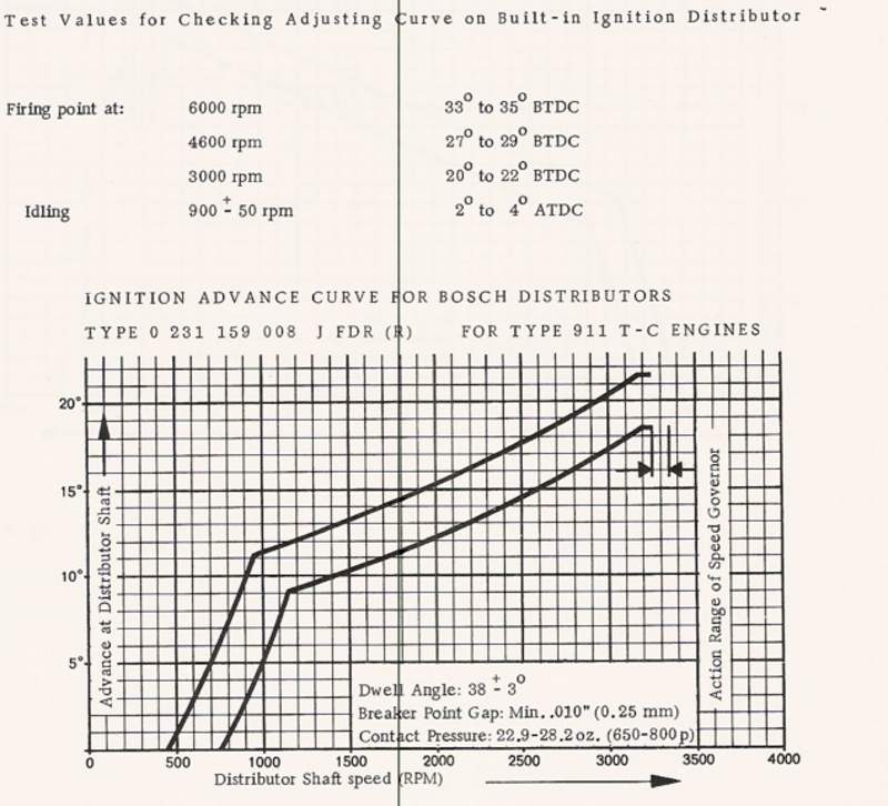

    I put the curves that have been published for the 2.0 to 2.7RS on this post.
    Olin
    Curves
    I must admit to being a bit dumb as I originally read the graph as two different curves. I now assume that the two lines are tolerances (Doh!).
    I am still interested to source parts, however, as it useful to be able to make changes.
    Thanks

    Yep those are the ranges permitted. I found out the best way to check a distributer is on a Sun dist machine (may be what you are using). Some of the old shops still have one. I thought mine was good and tight, but the weights did not move freely and springs were stretched. I to had a lot of bounce in the timing and could not get it to stabilize. I replaced it with a good used dizzy and smooth as silk.
