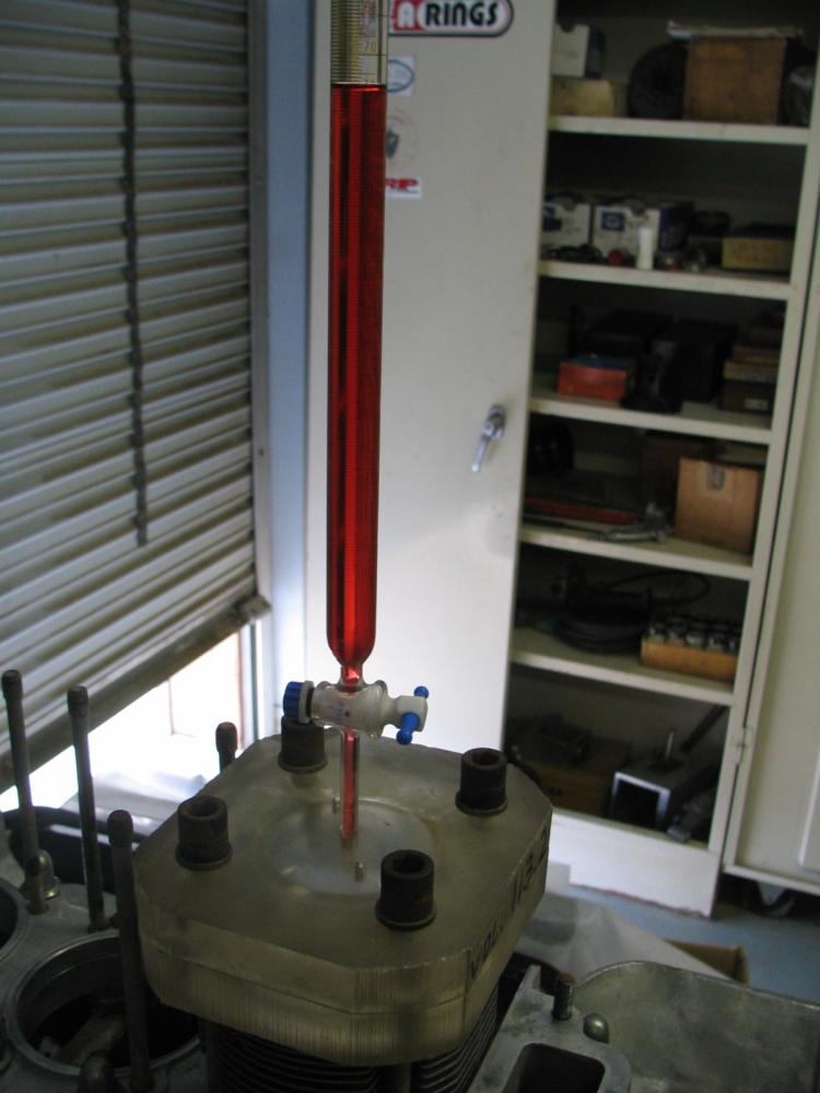

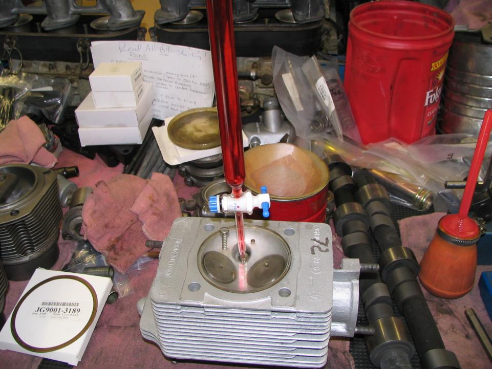

    Allen, since you don't actually know what your compression is (or will be) I would opt for the safe way and shim up rather than bring everything down. You could end up with too much compression. Anytime you build an engine with mix and match parts you have to have an accurate way of measuring your piston dome volume and cylinder head volume, otherwise you just don't know what you have!! A lesson I learned a long time ago is to never believe the C/R written on the piston box, there are simply too many variables.
    By the way, one method we use is to make spacers to bring the cam housing back up the amount machined off the cylinders.

    Allen, just so you don't think I'm blowing smoke here, here are some pictures of the method I described for accurately determining comp/ratio. We use various plexiglass cylinder heads in conjunction with a trial assembly where the piston is brought to TDC (using a dial indicator), the plexi head is installed and filled using a burette. This not only measures piston dome volume, but also will include deck height volume. Then measure the cylinder head volume, do a little math, and you will now have an accurate measure of compression ratio. If you do all six pistons and heads you can swap the heads around to give you the most even range of compression ratios. As an example of "don't believe the piston box" I recently did a 66 2.0 engine, I used 81mm JE's (not knocking their product at all) with a spec'ed C/R of 9.3. They actually measured out at 9.8 so I was able to shim up to lower the C/R.
    1st) plexiglass cylinder head, its volume is written on the head, when you fill it at TDC subtract fill volume from head volume, result is P.D.V.
    2nd) selection of heads, 356 to 3.6
    3rd) filling head at trial ass'ly
    4th) measuring cyl. head vol.
    Early S Registry member #90
