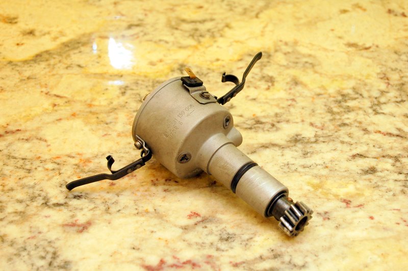

    Ed Fall at Vintage Werks
    Here is an example of his work on my cast-iron distributor.
    http://forums.pelicanparts.com/911-e...tributors.html
    http://www.vintagewerks.com/
    Barry Hershon did the aluminum-bodied distributor in my 911E
    http://forums.pelicanparts.com/911-e...stributor.html
    Contact info in both threads.

    I had some flaky problems with the 65 on my trip to Monterey, it started with that 20% ethanol from Nebraska, and progressively lost idle for the next couple of days. We rebuilt the webers in a hotel room, changed filters and was still not back to par. Jerry woods and his guys spent some time with the car as we rebuilt just about everything fuel related (short of flushing the tank). While "doing everything" Jerry verified the dizzy was within spec, which it was (on both dyno's), but after getting the car back to running right he went "the extra mile" and rebuilt it with new weights and springs - to get it spot on. The guy is a wizard.
    Car ran great on the return trip besting mileage at 30mpg at speeds over 80mph.
    This is the same Jerry Woods who had winning crews at LeMans, Daytona and Sebring and is still known for his masterful 935 thru 962 engines. Look for his ad in this months "Excellence".
    I had a pair of my "S" distributors rebuilt for the 67 race car by one of the other guys mentioned on this recommendation list - and he was OK. After having Jerry work on the 65's distributor I can whole heartedly recommend Jerry Woods.
