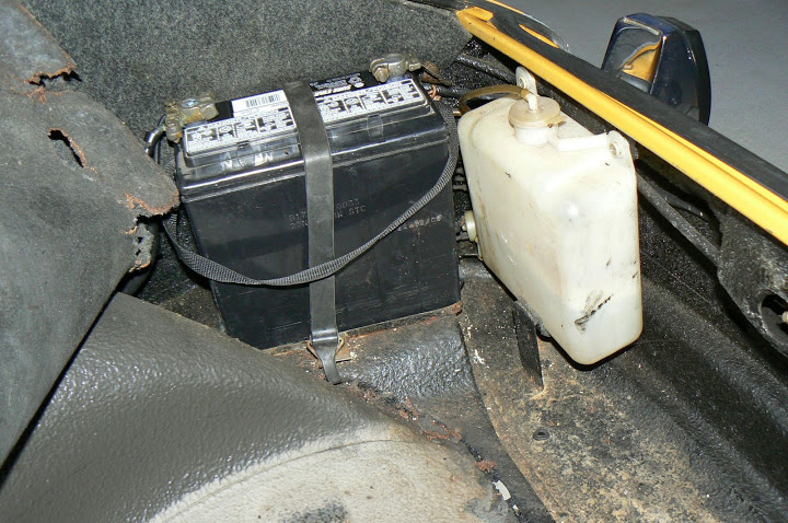

    here are two pics of the bracket ...Name:  IMG_9406.jpg
Size:  43.8 KBName:  IMG_9407.jpg
    Those brackets hold the trunk carpeting and prevent objects stored in the trunk from hitting the bulkhead. Common to all SWB chassis.

    i do have several swb`s here in my shop----some have them some not---does not matter if reutter or karmann bodies.
    `for example a 65` 301... does not have them, the 11810708 68`i just bought yesterday does also not have them...and there are no signs that anyone removed them ... 305528S + 306124S do have them 307662S + 308129S not,308131S has them again.(note that the last two cars are built at the same day ......and so on and so on... all cars are equiped with gas heater.
    on 912 i have never seen them(havent seen so many 912 so that does not mean anything).
    Mine (308454S july 67) has not them.
    Also missing on 308022S..
    Interesting, '65 #301111 does have them.

    305992S does have them and a piece of floorboard type plywood that sits behind them.
