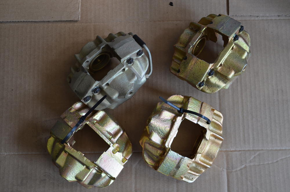

    I have had bunches of those things. Never on a 67, though. They are found on 64 and 65 911s and 912s, early 66s, too. Yup, the inner half of the rears is from a 356C and the outer half is from a 911/912. Here is a picture of 3 more and one 67 caliper

    If a 67 caliper has internal bridging and small diameter bleeders and a 356 caliper uses a bridge pipe and large bleeders Id say the 67 looking half is machined like a 356 and not compatible with a 67 half.

    We are only talking about the rear calipers. 356 fronts and 911/912 fronts are completely different and not the least bit compatible.
    Jim
    PS: A complete 356C front caliper will bolt on a 911 and work just fine. You just can't swap parts between the two

    Well... Jim nailed the rears. Actually, the "outer" 1/2 which hangs over the rotor is the 356 side. The "inside" 1/2, which mounts to the arm, is the later L-Caliper piece used through 1968.
    So... 66S that should answer that question. A 67 911 rear caliper, better known as the rear L-Caliper, is virtually identical to the 356 rear with the exception of the outer casting. Same compensating lines (bridge pipes) and same larger 10x1 bleeders. Jim's spot on, we usually see those in the 65 and 66 era cars.

    Is, of course, correct. The outer half is 356, not the inner half like I said (Note to self: Proof read your posts before hitting the send button, you dumbass!).
    Interesting note. The bolts that hold a 356 rear caliper are all the same length. When mated with a 911 inner half, there are 2 long bolts and 2 shorter length bolts, just like a "L" rear caliper.
