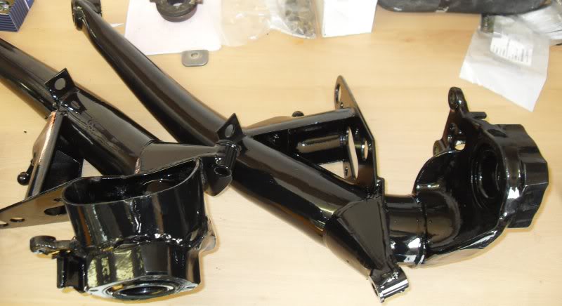

    Hi,can somebody explain to me what are the exact differences between a normal 911 2.4 T/E/S rear-axle trailing arm and the '73 RS one? Pics will help
    Moreover, I have noticed that the PET provides two different options for the RS (91133105310 and /20): what are the differences?

    RS arms have a strengthening piece welded on. Top of my hat, 5320 is the shorter trailing arm that came first with RS#1409.

    Thanks a lot! Do you have any picture?

    Here you go. You can see the extra reinforcing collar on the left one around the hub. Right one is a standard S version. Not mine, just a picture I found on some other site.

    I always thought that the reinforcement was only done on RSRs' Wider wheels and tires.

    It seems they started the reinforcing after the first 500

    Reinforced trailing arms started from the start of production on the RS. Gled

    if i remember right also the rs trailing arm was changed at some point of production...hmmm have to have a look into the RS book........once met the guy who did the welding on the right side trailing arms for the rs...it was pice work for a sub contractor....he told me that every trailing arm got a small white QC stamp....just a anecdote

    Here more info on the shortened trailing arms, from VIN#1409 standard and used for the RSR's.
