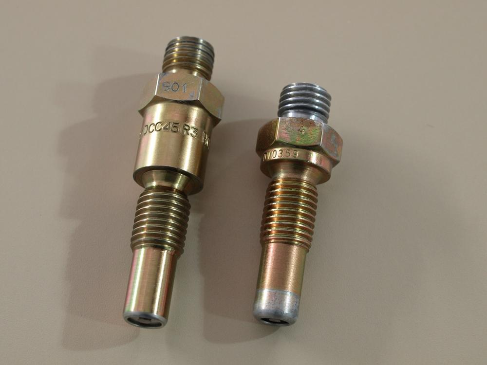

    You just don't get to see one of these often. The short one.

    What's the application? And difference in performance?

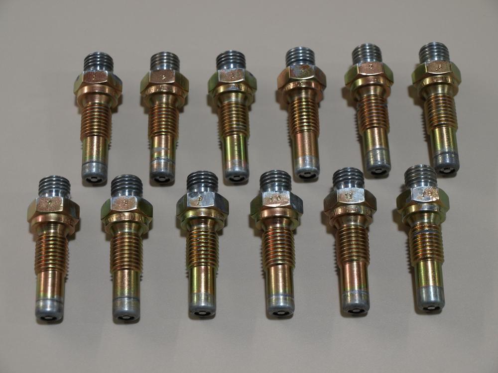

    Application is for the 917. I ultrasonically cleaned the set of 12 and then did a pressure test. I then flow tested the injectors and saw a perfect cone spray pattern from 1,000 rpm to 8,500 rpm. I have tested many standard 911 & Mercedes MFI injectors but have never seen such a perfect cone spray pattern as these. Tom from Ed Pink Racing Engines sent them to me for cleaning & testing. Frank Honsowetz and his team at Ed Pink Racing are rebuilding a 917 engine for a customer.
