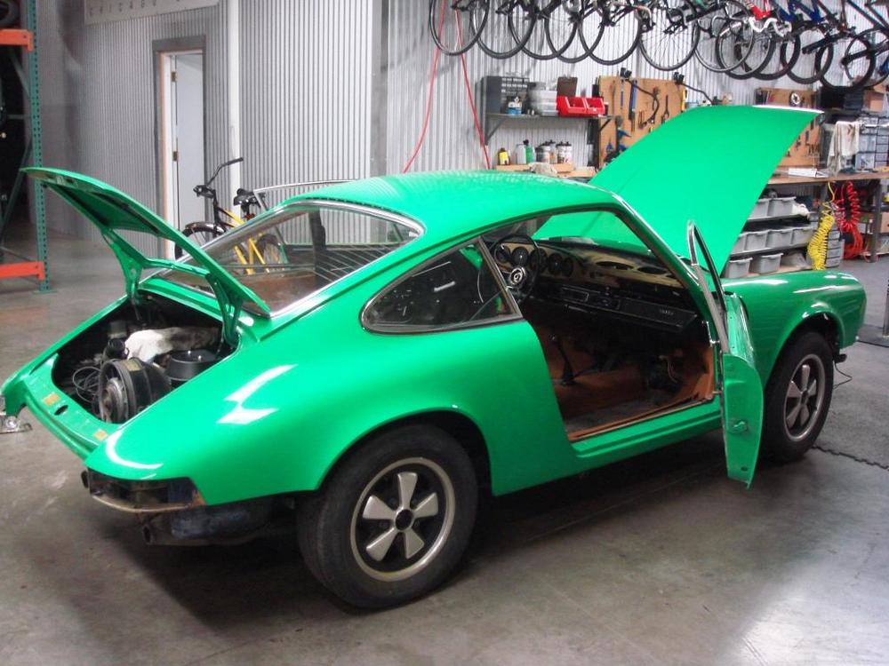

    Night job
    I spent my evenings of those three months in San Luis Obispo assembling the car in the warehouse/workshop of my company’s offices there. As I did so, I knew it was temporary, and it would be coming apart again someday – someday soon, I hoped. To my delight it did indeed drive quite well when put back together and only needed a little tweaking here and there, such as rebuilding the carbs and brakes.
    The pictures below were taken by Aaron just before it went under the knife. At first, Aaron was hesitant because it seemed a little too nice...but he soon changed his mind (as I had in 2007) and decided it was just the right amount of wrong to use as a donor.

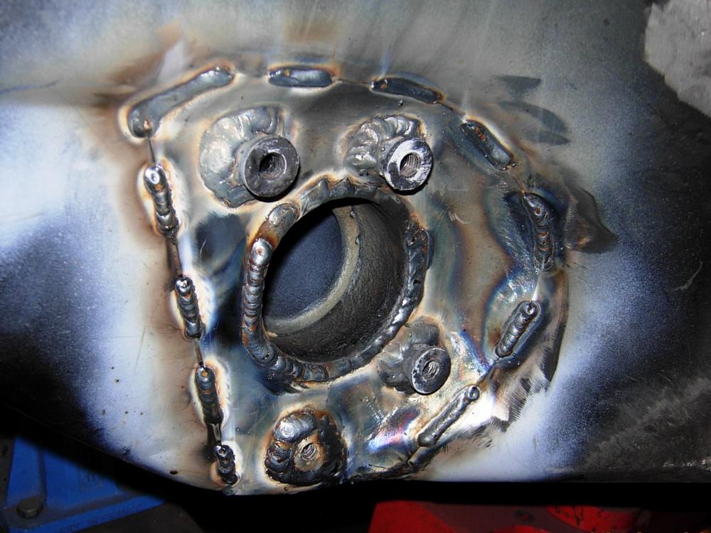

    Chassis: extensively reinforced
    Extensively reinforced at all front and rear suspension pick-up points, front and rear shock towers, transmission tunnel, front inner fenders.
