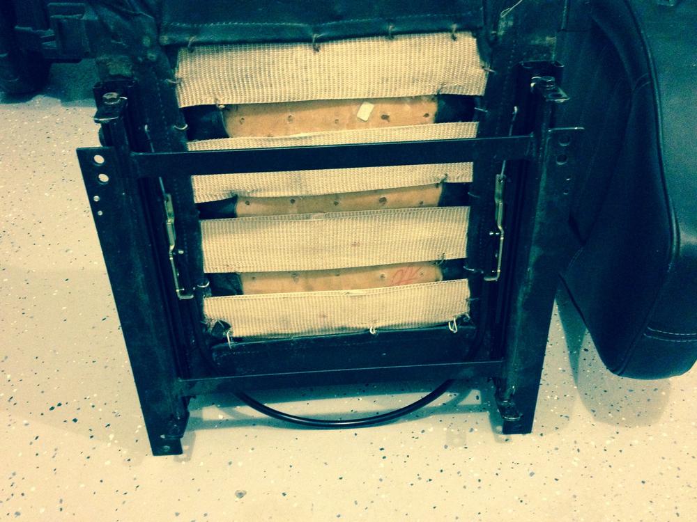

    Here's what I have on a seat I removed from one of my 1972 911s. I think this would scratch your itch because it can be adjusted up and down. Notice the slider adjustment bar.
