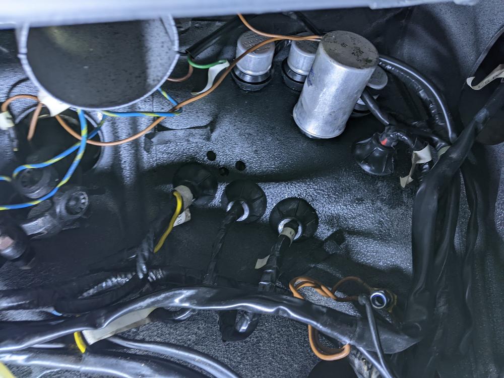

Reassembling car, struggling with wire routing. I am assuming the tall flasher goes in the trunk, but unsure of it's position. Would it be possible for someone to post pics of trunk plug locations as well as drivers side under dash?

Thanks for the pics and I think my main question is answered. It looks like the tall Hella flasher goes in the trunk with the plug going through one of the large holes. My car has 3 small cans in the trunk and this one makes 4 total. Is there an additional short can behind the Hella unit?

1 Attachment(s)
Thanks again. Here's where I ended up and I think it's correct - BTW, plugs on 50 yr old car a bitch to push through holes!
