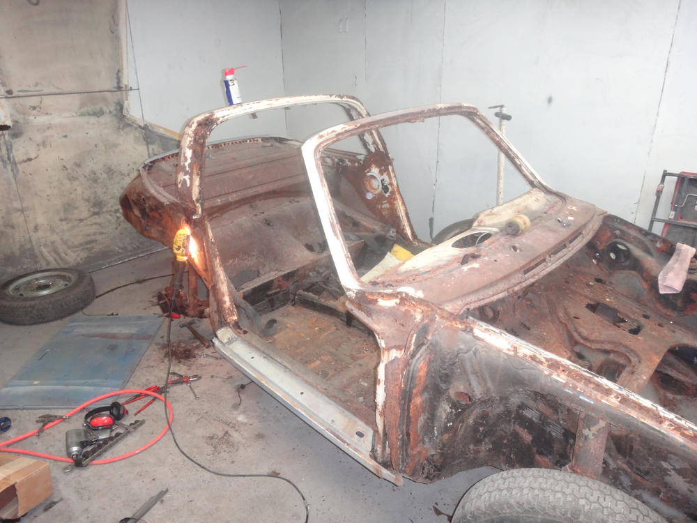

Thread updated finallyConsolidated everything here: http://www.early911sregistry.org/for...-the-aftermath Made a few separate posts before I realized I should consolidate The baloney is the line I’ve been feeding my self about how smoothly this would go. The Swiss cheese is all the pinhole rust that will require replacement metal. Only caveat so far is the Hagerty price guide. Had a company called Mobil Blast Away come to Dale Erdman’s shop yesterday. We had previously removed everything would could take off and actually cut the rear quarters away. The chassis looked pretty rough but the longitudinals were in surprisingly good condition. Probably what kept the car from splitting in two when it was originally towed to the shop.
Decision was made to have everything chemically stripped that was removable. I read to many things about residual blasting material in crevices that would appear for years after blasting. Redi Strip in Allentown, Pa had closed its door for various reasons. At first I thought I would have to take everything to Ohio as it appeared to be the closest chemical stripper. Then I found Metal Strip of New England in Worcester, MassachusettsAttachment 303993
In our initial assessment of the car, it appeared that the pans, fenders, front hood, center tunnel and rear seat pans could not be saved. Doors would have to be re skinned and the front bumper was doubtful. Quarter were salvageable but rough and the front bumper was extremely rusted. Just so happened at the time of the purchase, a nice guy in Virginia was giving up on his ‘67 912 and cutting it up. Went down and purchased the fenders and front hood, since NOS was no longer available. Car was so clean that I discussed it with my body man and we decided to buy the front clip. Appears that by the time we finish with the clip, it will look like a turkey carcass five days after Thanksgiving. I have decided not to just clip the car, because that impairs the value of the Targa by essentially becoming two cars into one. Can’t use the original fender but transferring the light buckets because they have the original vin stamping. Will re stamp the hood and will divulge that upon sale. Also picked up a new front bumper and may elect to use that instead of the original.

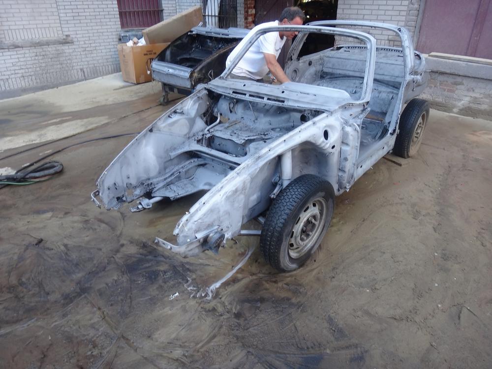

After pulling out the instruments, interior wiring, engine and transmission we were ready to blast the shell. Could have loaded it up on a truck and carted it to a facility, but I found Mobil Blast on the web. Called up and talked to Mike who was willing to come out to Allentown, Pa to do the blasting. He is located in Pawling, New York and covers NY, NJ, PA, CT and maybe as far down as Delaware. He was doing a job in Trenton close to where I live and split his day in half. Blasted a truck frame in the morning and then he rode up to Allentown. Dale had the car outside and they set right to work. Took about three hours but they cleaned up everything but the floor pan which we are going to replace anyway. 90 degree weather but Mike’s assistant Pablo donned his protective gear and had at it. Mike says they have various grits to remove different types of coating on different materials. He sells the particulate to other blasters. Also keeps his shop open on Saturdays and if you can hall it in, they will blast it there at the shop. If I got it correct, the particulate is a slurry of water and ground up glass bottles. Dale reported to me that when he cleaned up this morning the left over material was like mud/snow. Took about two hours to shovel it up but no residual damage to the shop or surrounding area. Seems to be environmentally safe.
Cleaned up the clip at the same time and you can see the chassis and the clip in the picture below. Going to take the nose panel and slam panel as well as a small portion of the bulkheads on each side from the clip and graft them on to the chassis. Probably will need to take a portion of the trunk floor as a repair panel also. Really have not decided how ro proceed with the rest and guess it is a work in progress subject to another update in the future. Obviously we will be welding new underbelly, seat pan and tunnel into the car.
