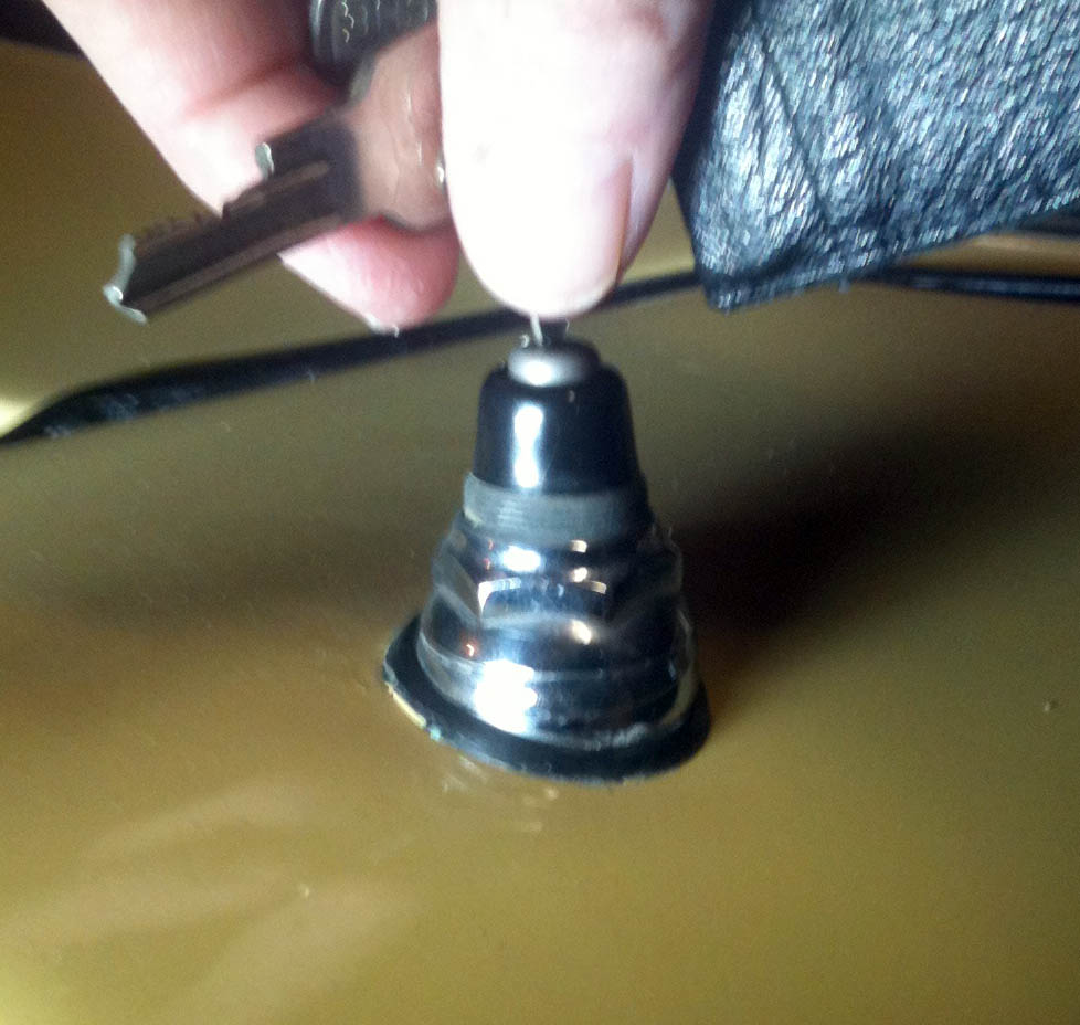

Here's a Hirschmann antenna key (it's the little cross-shaped key on top):
Attachment 318828
And here it is inserted in a Hirschmann antenna:
Attachment 318829
The Hirschmann key has to be turned after inserting it in the antenna top.
