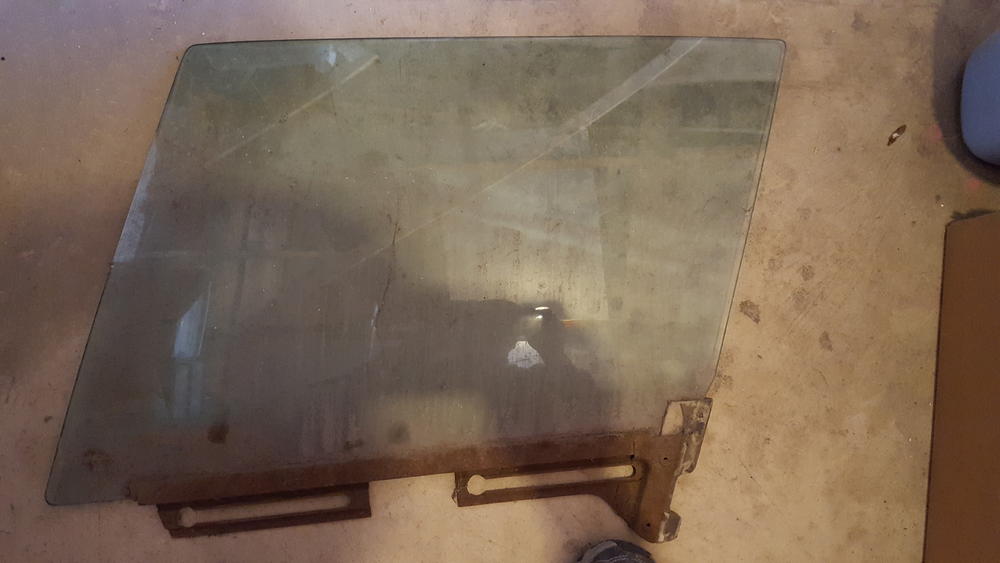

Jim, Moito,
Thanks for the help. Based on Moito's pics, it looks like I have a set of each. Not great pics, but they appear to match Moito's descriptions and pics. Are all '70/71 targa roll-up windows tinted, or was that an option? As my targa window looks tinted.
Targa?
Attachment 410123
Coupe?
Attachment 410124
Thanks!
both available tinted and clear ....not sure if tinted was standard for US cars..but all US cars i had had tinted
Moito's description of the shapes is very good. 67 and 68 Targas came with both tinted and clear glass. I'm pretty sure that 69 and later Targas were all tinted (in the US and probably ROW, too). Coupes came both ways, but predominately tinted. The Targa glass is shaped a bit different at the bottom, too. Note the pictures. The Targa window channel is quite different than the one for a coupe.
