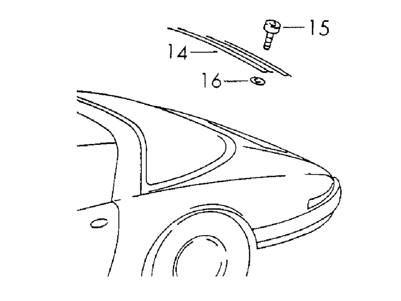

Missing the attaching bolts on my '72 - '73 engine lid grill, what are people using in place of these. I don't see how you could get the original t-bolts back into the slots.
Try doing a search here. This was discussed in a thread less than a year ago
PET 70-73 911, Fig. 8-10-11, #14 911.559.041.02 Ventilation grille, '72- Qty: 1 PCNA List 2017: $1080.01
PET 70-73 911, Fig. 8-10-11, #15 900.119.036.02 Pan-head screw, M5x12 Qty: 6 NLA
PET 70-73 911, Fig. 8-10-11, #15- 900.151.027.02 Washer, A 5.3, '72- Qty: 6 $0.41
PET 70-73 911, Fig. 8-10-11, #15- 911.559.151.00 Base for ventilation grille, '72- Qty: 4 NLA
PET 70-73 911, Fig. 8-10-11, #16 999.031.084.50 Rubber washer (spacer) Qty: 6 SS 91155943500 $0.50
