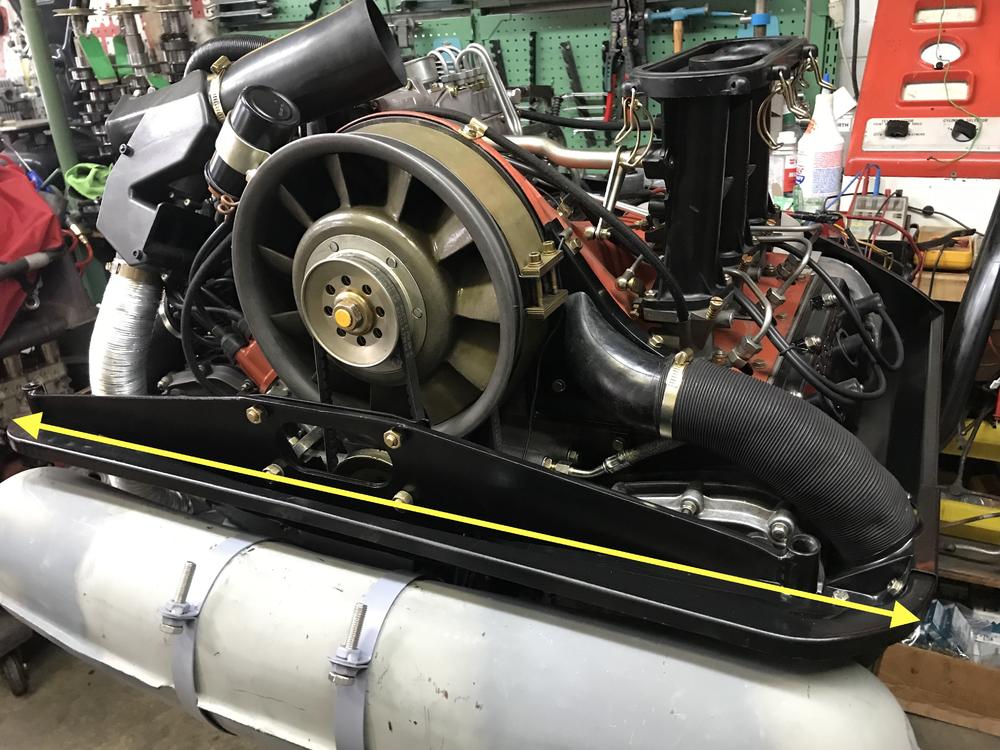

Once winter comes, I'm contemplating dropping my engine/transmission to address a number of annoying leaks (drips really). Maybe I'll just decide that the smell of burning oil is tolerable, which it is. And maybe this is just asking for a world of headaches. While I think virtually all of these leaks can probably be done with the engine in the car, some things like the rockers (if they are indeed leaking) are just easier done with the engine out of the car.
I don't have an engine stand or an engine hoist, and would prefer not to purchase them. Not so much for the money, but because I am running out of place for things. So I was going to make a trolley out of 2x4 and 4x4 pieces with some wheels that could go under the engine/transmission. The idea is to lower my car on the 4 post lift with jacks under the rear body points, unbolt the engine and transmission mounts and then lift the car back up using the lift, leaving the engine on the cart and easy to move around my crowded garage. Resting on the cart should make it easier to move the engine back to clear the shift rod etc.
Anyone ever done this? Any drawings or pictures? I realize the cart will need to be narrow enough that the lower valve covers are easily accessible, and it's easy enough to remove the heat exchangers. I don't see any reason it should't work, except for whether the engine with its tin will clear the gap between the ramps of the lift. Yellow arrow in photo. Anybody know what this dimension is for a '73 MFI car?

I had the same idea, but when I put the car on the lift (direct lift 9000) it was obvious that the engine was too wide. It was pretty easy to just use a floor jack to lower the engine to a furniture dolly.
Good to know. I have Direct Lift Pro Park 8, and I suspect the ramp widths are the same on all their models. Eyeballing it, it looks like it might work, but eyeballs being what they are at my age.....

The distance between my ramps is 35 1/4. The heat exchangers look to be around 35” wide. I think the big issue is that there just won’t be enough room to reach anything. Maybe if you had everything ready to go but the engine mounts it might work. Of course then you’d have to push the car on the lift WITH the engine in it!
That was the idea. Remove everything, including heat exchangers if needed. Lower the lift so engine and tranny are supported by the built up cradle. Just a bit higher than the bottom most safety lock on the lift (about 24” above the ground). Undo the transmission bolts and engine mount bolts. Raise a bit, pull assembly back to get the shift lever out of the tunnel and then raise the car completely up towards its parking spot in the sky.

Turns out there are some threads on this at the Pelican. Two approaches. One to drive the car as far back on the lift as possible and then drop it off the back (hard with the transmission attached) and one to widen the ramps. On my Direct lift you can actually move the left ramp (the one without the hydraulics) another 3 inches over. So that makes a between ramp drop on to a atv lift or dolly quite feasible.
Anyways, not sure I need to do any of this, but was interesting to read about.
