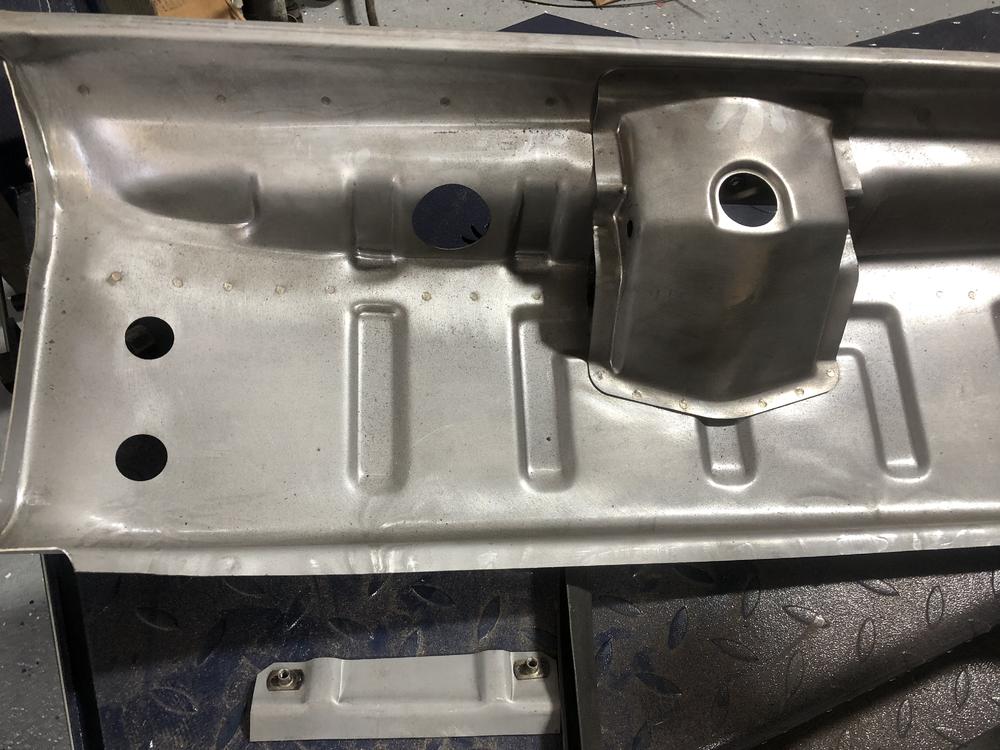

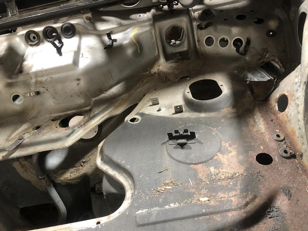

Where was the washer bottle located and how was it attached in a 73 911 with factory A/C? I think it was attached to blower motor cover but not sure of location or attachment mechanism. Pictures and pointers to attachment parts appreciated.

It attaches on the left side of cardboard 4 bolt protector of the blower housingAttachment 554021Attachment 554022Attachment 554023. It sits into a bracket then held fast with a rubber strap and is under the carpet with the filler sticking through the carpet
