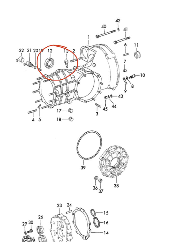

What is best Transmission output shaft seal?
Mine are brand new and leak.
Does someone have advice on what works... What to avoid?
Attachment 564191
Attachment 564192
Attachment 564191
Attachment 564192
