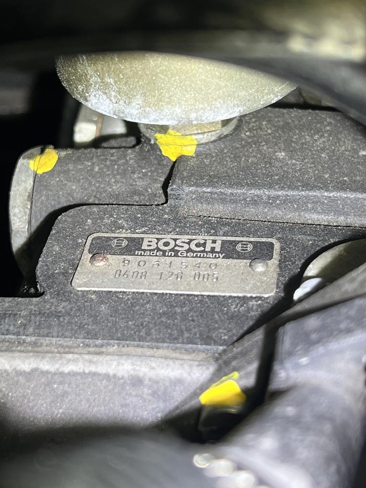

The case and transmission are indeed numbers matching, but after a bit of investigating and using my trusty boroscope, I've realized this car has K1819n heads. Based on a few grids I've seen floating around, I think these are 72/73 911T heads (they have casting numbers of 911.104.302.OR). These appear to have valve sizes of 46/40 vs the original E heads of 42/38, but the port sizes are smaller. Maybe the heads were ported to match the S port sizes of 36/35?
Is there a "standard recipe" for hot rodding these 2.0 motors that would include these T heads and perhaps S cams? Any other things I can learn about the motor without taking it apart? I've seen reference in the record book of this being a 2.2...
