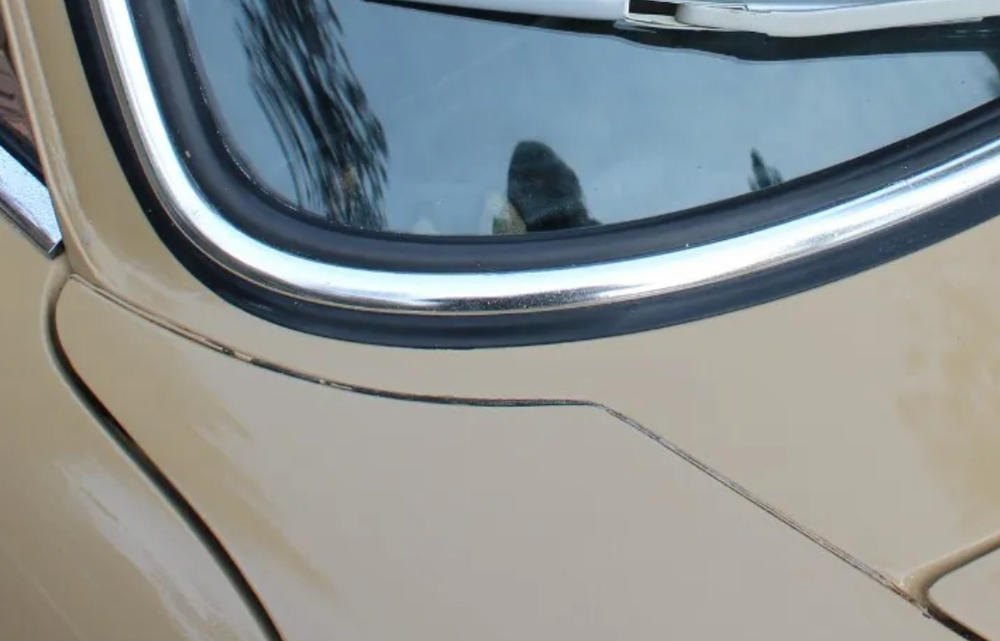

Hello.
I have seen the fender to cowl seal that looks like rope.
Does anyone know what years they were like rope?
And just curious, what was it made of?
I am fixing a car built in sept 1965.
Attachment 611904
Hello.
Attachment 611904
folded leatherette with a cord inside...early cars did not have the cord ...not sure when it was introduced..
car in the foto appears to not have it
Thanks Franz! I learnt something new today and it is only 6:17 AM.:)
Exact same material as used in the interior. I used some old original scrap material to ensure originality
Not sure when a cord was added but 301318 (May, '65) just had folded interior vinyl as pictured with no cord.
