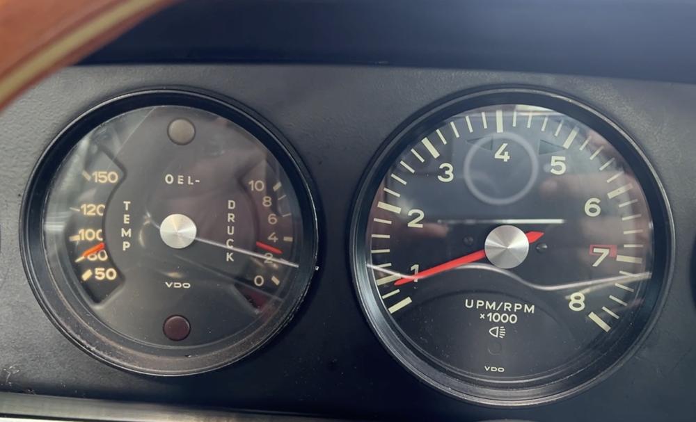

Idle RPM tendency to increase with outside temperature (MFI)
2.0E stock MFI.
Everything was perfectly tuned this winter : dwell, timing, idle spot on at 900/950 RPM with a CO at 3% :)
Outside air temp around 10°C :
Attachment 636716
Last week-end, weather getting hot in my area, around 25°C and now the idle RPM increased to 1050...
Attachment 636717
Of course oil temp increases with the OAT, and my understanding is that explain why the idle RPM increases also.
What advice would you give :
stay like that ?
Close at little bit the 6 idle screws ?
reduce a little the advance ?
Thanks !
