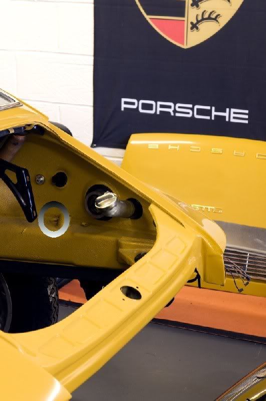

The hole for the bumper arm is here
http://img.photobucket.com/albums/v4...umpermount.jpg

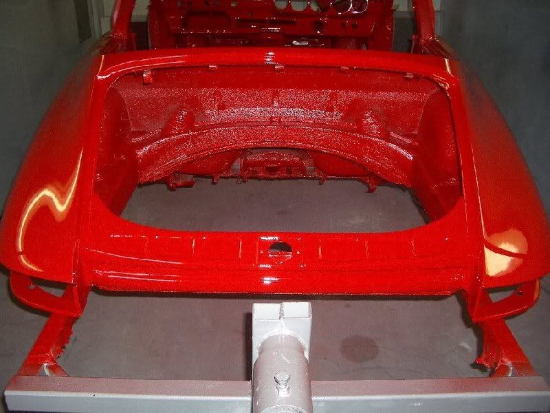

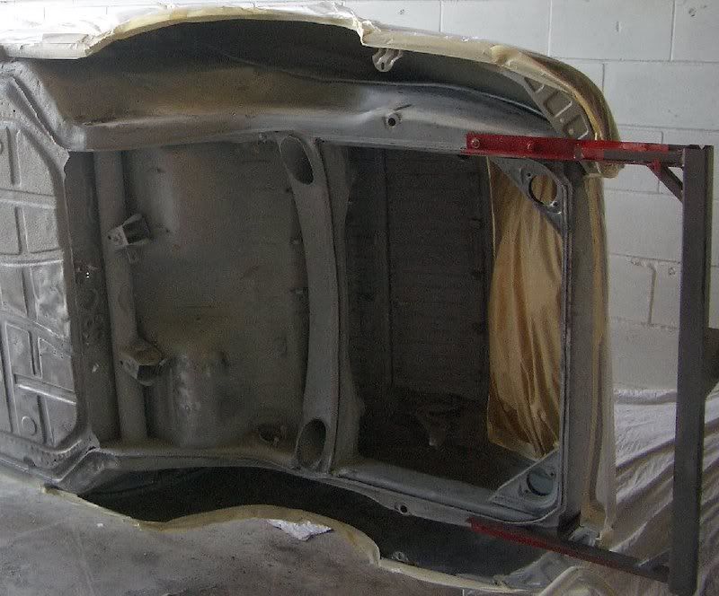

We mount the rotisserie using the mounts for the rear bumper.
http://img.photobucket.com/albums/v4...y/rearspit.jpg
http://img.photobucket.com/albums/v4.../rearspi1t.jpg

I got the car in pieces, and the arms are gone.Thanks very much for the info, and for the rotisserie mounting pics.
