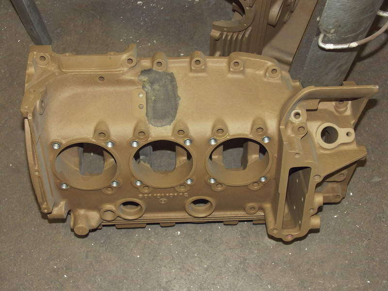

911 Weber manifolds are magnesium.
The early ones received an iridescent yellow-blue "chem film" or other surface treatment. I have posted some photos of what they looked like here. The later ones were coated with a black "imron" which is extremely durable.
Replicating the early coating is not only hard to do in terms of the color, but it's also a good idea in terms of preserving the magnesium- 40 years of moisture and corrosion have taken their toll on the original surface, which is revealed after the manifolds were ceramic tumbled and surfaced.
Anyway, here's the issue- you can't just Cad-plate magnesium manifolds using the same process you use for steel-- the first step in the plating process is a "strike" or acid dip to activate the substrate, then the plating starts. Unfortunately, if you dip magnesium in the acid. . . it will go away! The plater wouldn't even take these the first time around.
Turns out you can plate the magnesium with an alkaline process that doesn't dissolve it-- you plate with either flash copper or electroless nickel. Then you do the cad/chromate process normally. Flash copper is the best substrate, so that's what I did.
This whole process was done at Millenium Plating Company in Lowell, MA.

Steve can also do the other mag parts. . fans, blower housing, magnesium valve covers, etc. I'm going to do the fan for my race car in Electroless Nickel. . . not only will this look great and be easy to keep clean, the abrasion reistance will be extremely good.
OK, time for the photos. . . . are you ready? I included the original shot to show what these will look when they are done.
Price for mag plating is available from Steve, it's not inexpensive, something like this is around $200.
