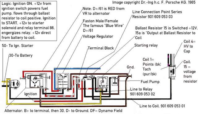

Not sure if 64 is different from 66, but my 66 uses a special [Bosch] coil (I'm not with my cars now so I can't get the ID number) depending if car has stock ignition setup where power to coil first goes through resistor (small box on electrical panel with coiled wired wrapped around insulator) to drop voltage to coil to below 12 volts. Coil is only fed full 12 v on original ignition setup when cranking the starter motor (bypasses the resitor via a "step-down" relay also mounted on panel), to help with starting. The same yellow wire from the starter loops back to feed the step-down relay, which serves to send 12 volts directly to the output side of the resistor, in effect by-passing the resistor only during starting. When you stop cranking the engine, power to coil is allowed to come through resistor, which on my 66 is about 11v. Hope that made sense.
1 Attachment(s)
John, that is the way all the SWB kettering ignition operates, from 64 through 68, even though the 68 has a ceramic ballast resistor instead of the Beru or Bosch box-type with screw-on cover.
More here:
http://forums.pelicanparts.com/porsc...electrics.html
