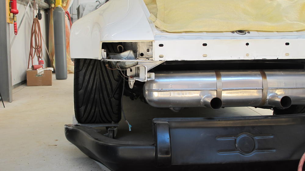

Several months ago I received an email from Peter inquiring about backdating his already stunning looking 1974 911 RSR. From the pictures he sent of the car, I could see that this was a very special Porsche. I took a trip south to Santa Cruz and met Peter and saw the car in person…I was amazed! Not only was the car well built, but more importantly, Peter’s enthusiasm for seeing the backdate project through was infectious. That’s all I needed to shake his hand and proceed with the project. The project scope consists of installing a long-hood, front and rear fiberglass bumpers, steel framed ducktail, fender extensions, rear 911 R tail lights. You can imagine that these projects are not a walk-in-the-park if you want a perfectly clean look. The fact that this car is a pristine street racing car will challenge me to make all these panels fit perfectly with a few custom fabrications.
